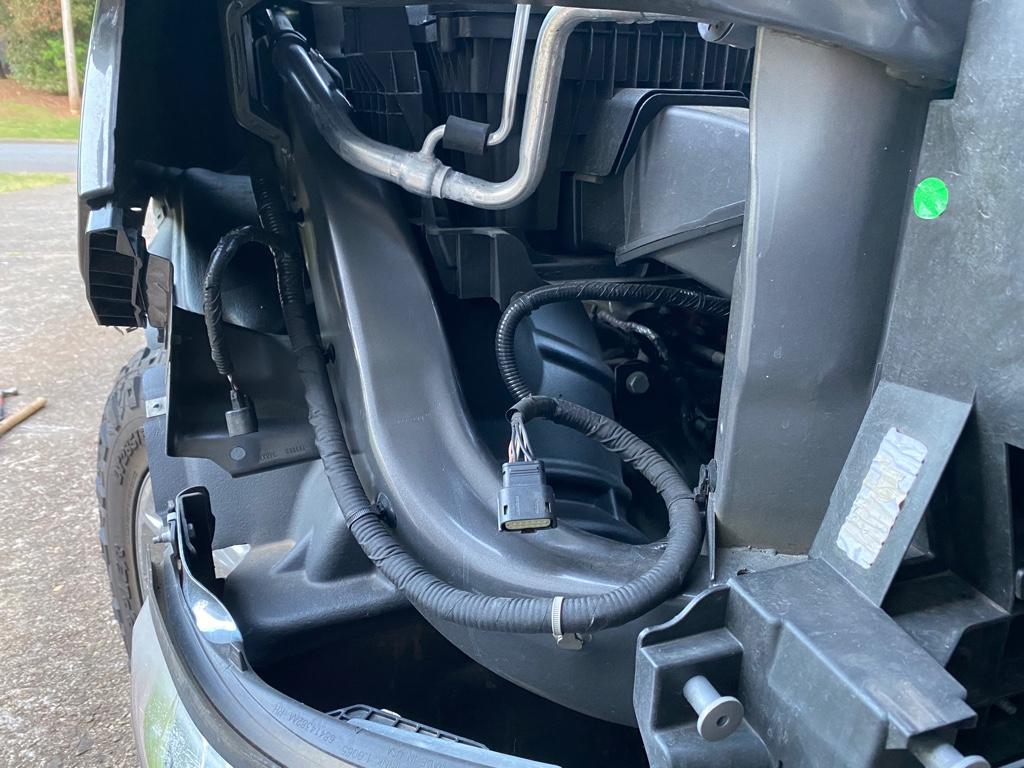

Im just now getting around to installing mine as well i have the stock halogen. Im assuming that we leave one of the stock connectors off/unplugged
You won’t need the smaller harness. Just secure it with a wire tie.
Correct. The wiring harness for the side markers is not needed in the new headlights.
I put some electrical tape around them to keep them dry and zip tied them up and out of the way.

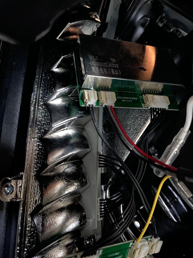

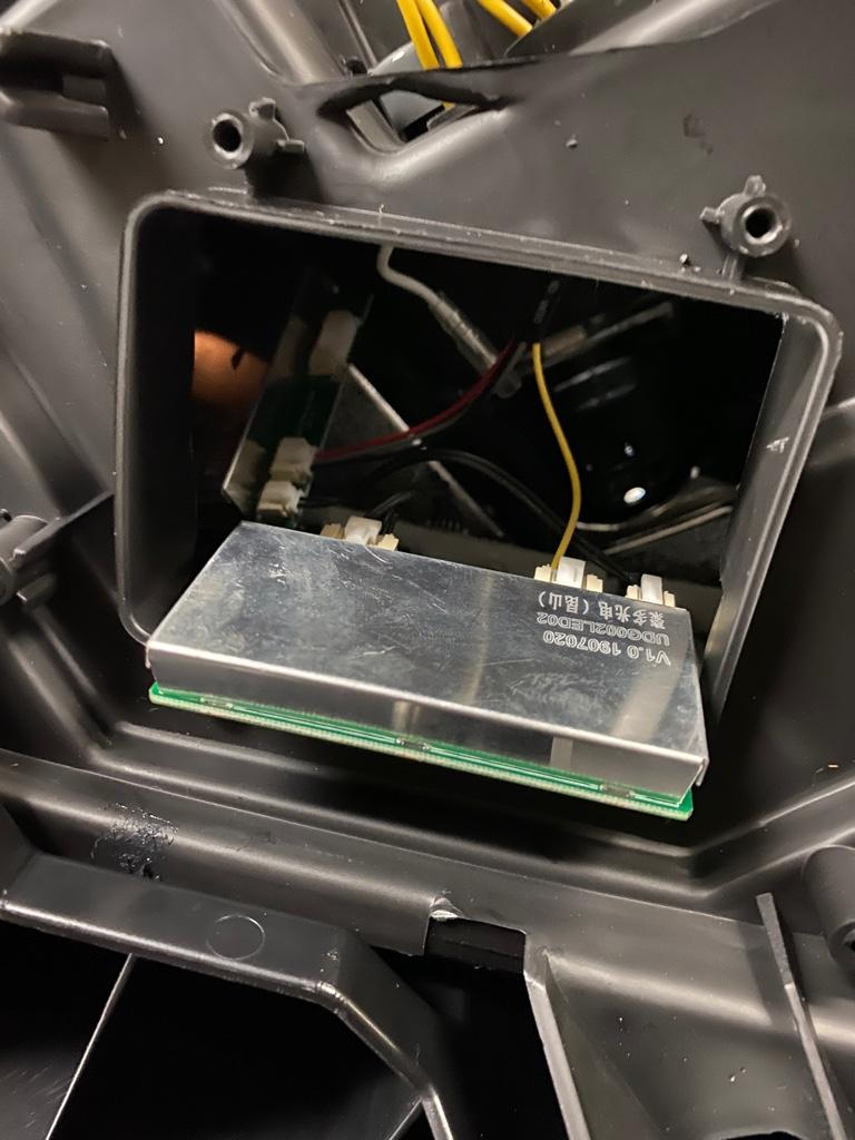

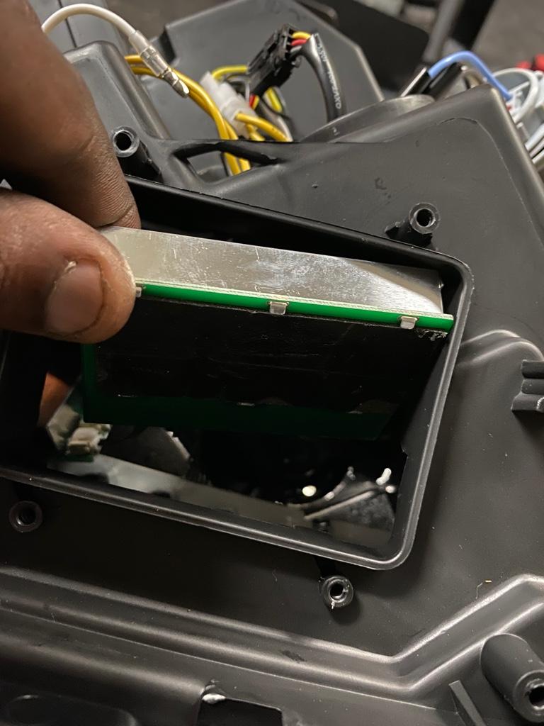

Both pieces came lose from double side tape. I have my whole front truck apart DAMN IT!!!!! I’m going to check the other one on the passenger side that I already have in. Report back shortly
Well, the passenger side is all good nothing rattling around on the inside....
That happened to one of my headlights from shipping. I just put some 3M double sided tape and secured it inside the housing.
That happened to one of my headlights from shipping. I just put some #M double sided tape and secured it inside the housing.
Did you just put the new tape on top of the old or what? I have two that can lose trying to figure out exactly where they should be. Kinda hard to get your hand in there and clean it up where I think one came a lose. Thinking maybe some
Yes, I did not attempt to take the old tape off, just put some new tape on the old and stuck it in a secure location. Like you said you do not have a lot of room to get your hands in there unless you have a small child in the house.

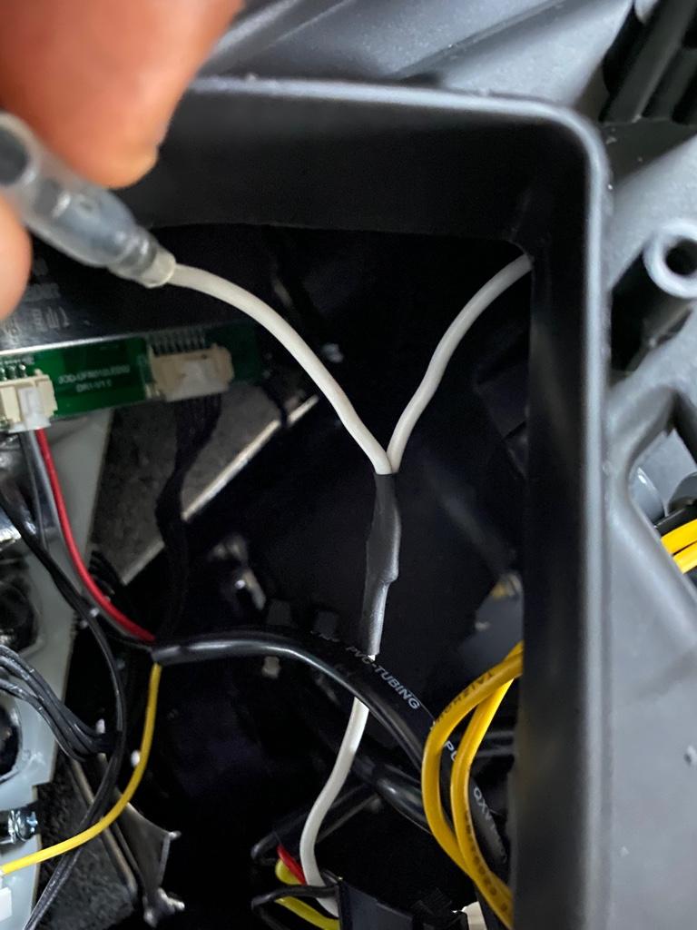

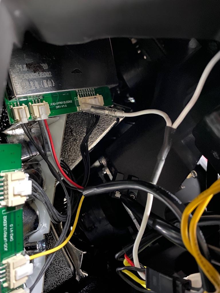

Well I’m trying to secure all this stuff that was lose and rattling and noticed a wire hanging free not for sure where it goes or if it needs to be hooked up. I haven’t heard from ALPHAREXUSA
If my memory serves me right. I believe I had that extra non connected wire also inside the headlight. I opened the second headlight open that did not have any loose modules and it also had the extra non terminated wire. (I think it is just an extra wire.) The probably use the same wire harness for many different headlights.
Just make sure everything works after you wire them up and before you put the grille and those fascia back on the truck.

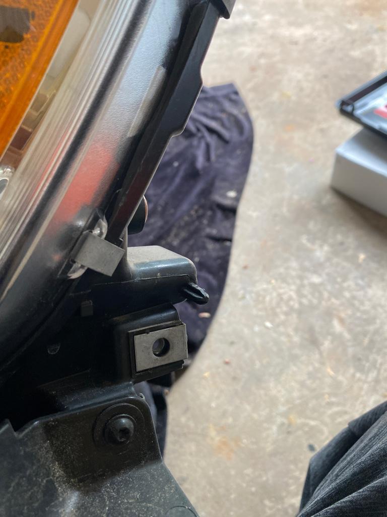

Also those who haven’t installed these you may have to transfer clips off your old housing like I did
