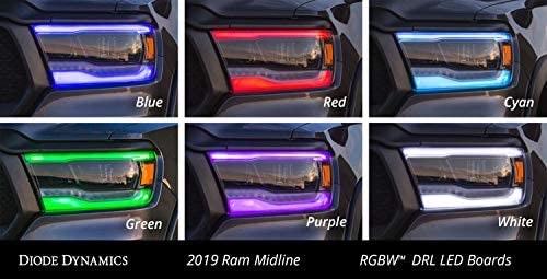

Diode dynamics makes a replacement RGB board for those LED accent lights if you are comfortable breaking the seals on the OEM housings. I looked into them but didn’t like the colors offered. If amber was an option, I would have them installed already.
Edit: just watched the video and it looks like there is an infinite color wheel so you can select whatever color you want. Now I wish they weren’t $255 cause I think I need a set.
Diode dynamics makes a replacement board for those accent lights if you are comfortable breaking the seals on the OEM housings. I looked into them but didn’t like the colors offered. If amber was an option, I would have them installed already.
Amber IS an option, if you look at their listing they allow you to set any RGBW color, so you can manually set it to amber.
I can't believe how cheap it is!!! Only $290.
Problem is, this will not work on a Limited per their faqs.

I mean can alpha obd make the bottom turn yellow too instead of white like I have set the top to be.
Since there are no amber led chips on the lower led board, there’s is nothing that can be done except change the led board. The upper board has a series of amber and white LEDs on the board for turn signals and signature/park lamps.
Here are the RGBW boards for the Limited, Longhorn, and TRX Rams.
