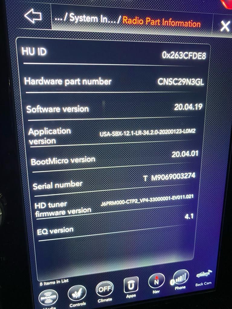

If/when I do the PR39 update, will I lose changes already made with Alfa in my current version like DRL location, Tire Programing for diameter etc, and have to redo all the changes again, or does it carry over and remain in the new update?
The software update is for the head unit itself, not the BCM, so it has no effect on anything you have currently shanged with alfaOBD

Need to update it
Where can I find the update?.. or can someone post it here. Do you have to update to each one and get to the current or can you just go straight to the current?
Check the post higher up. It's there
You have to be on the latest update PR 39..
