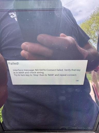

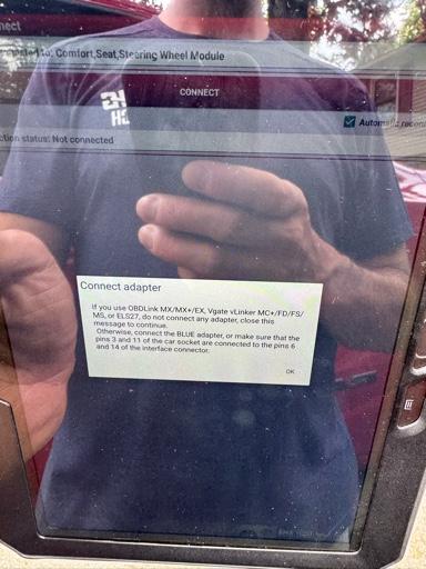

correct on the module as shown. below shows what I get every time.
I need some help. I cannot connect to the comfort module. I have no problem connecting to the suspension and BCM modules. I have tried 3 different OBD scanners assuming that was the problem. Latest attempt was with a vLinker MC+.
Any idea why? Thanks!
I even tried the OBDlink MX+. Still can't connect to "comfort" module.
Nandalora, I noticed Jimmy is using the Windows version. Are you using an Android phone or tablet? Maybe the problem is it only works on Windows.
