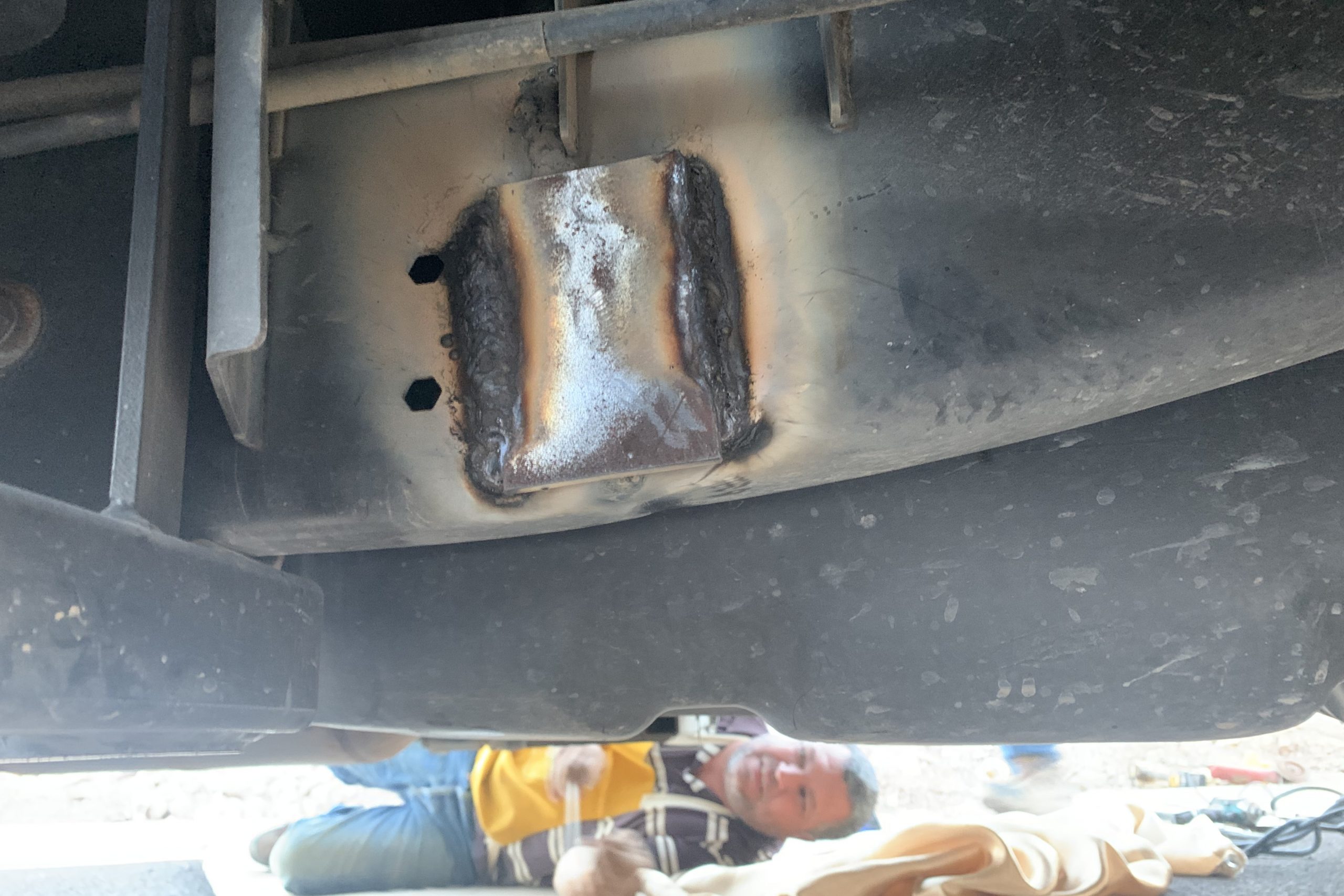

Another thing to consider when going over weight limits. Too much weight can destroy your frame. Although this guy’s insurance paid for the repair, I wouldn’t expect to ever see that happen again. Thankfully he was able to pull over somewhere safe and didn’t lose control and crash.
