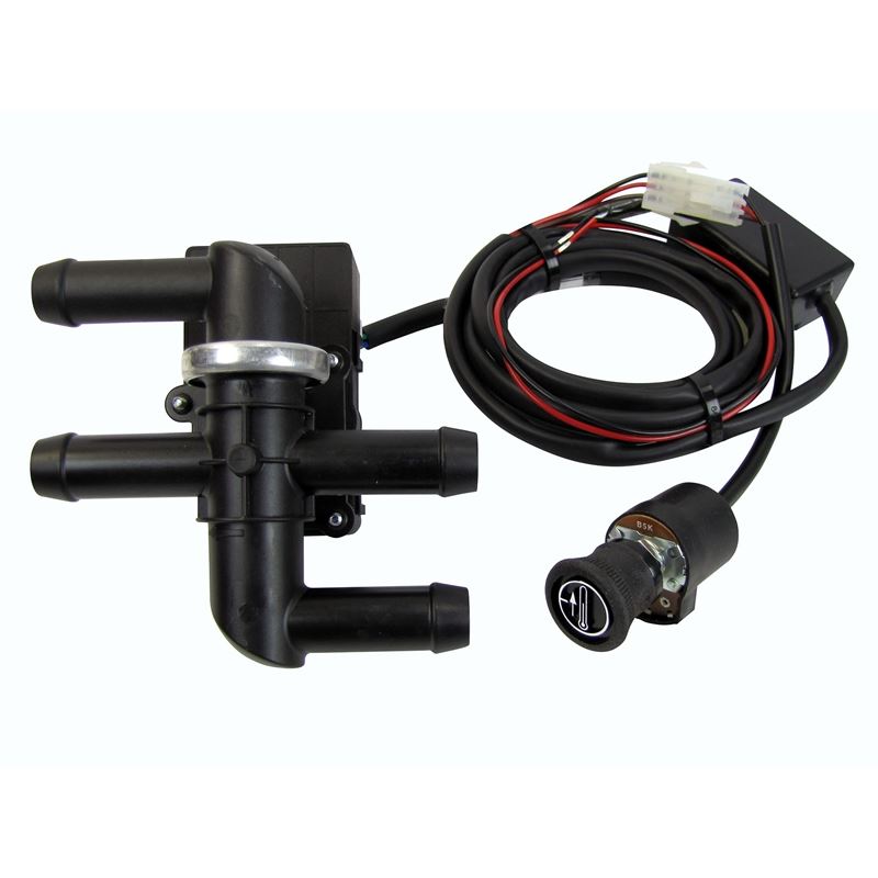

Is there a 12v variable valve that you can control remotely? I would like to able to control how much flow is restricted without having to pop the hood.
This is what you're after.
12V electric heater bypass valve with remote variable control from all the way open to completely closed and everything inbetween.
