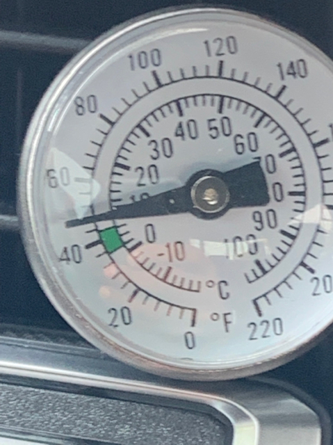

Hack installed , nice and cold. I had to use the clamps from HF, as I couldn’t get the dang hose off . The AC feels much better now !!
I couldn't get the front hose off either, but I did get the back one!

Very interesting, what in the wide wide world of sports could be happening here? With the system producing low 40s with out hot water contamination, seems like the refrigerant fill is not the issue. Keep us posted, even if it is just your educated Theory. thank you for your contribution.
