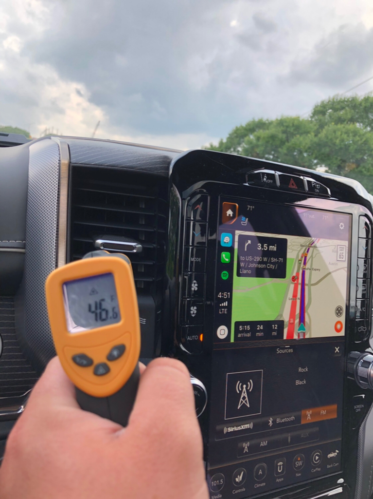

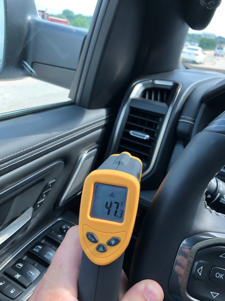

Hey everyone! So I’ve been reading up on this thread and it put a pit in my stomach seeing as I live in Texas and just dropping some serious (to me) cash on a new limited! Mine is a 2019, build date is December of 2018.
Today was about 91 outside and humid as it gets. I put the air on 71 without the recirculating on and got like 47 out of the center and 47/49 out of the left front vent. This was about 5 min after start up.
You might check passenger vents too, passenger side on mine was 4 degrees cooler.
So are you one of the lucky ones that has cold, strong air blowing?
I haven't hit the 110 degree day yet but I have hope that mine is blowing a cold 46 degrees on a humid 91 degree day.
