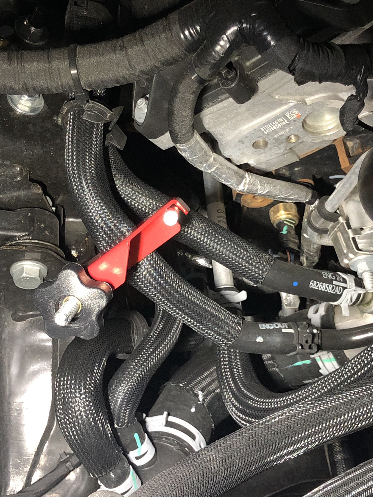

Finally catching some breaks in the hot weather. Had some cooler mornings and days lately. One bad thing about the HF clamp is that it's all or nothing. When it's clamped, you get cold A/C all the time. There is no heat. I assume that with the valve, you guys are simply adjusting the flow of the valve accordingly as the temperatures are changing, or is it still an all or nothing on/off situation? I'm trying to determine if I should switch to the valve now, or just pull the clamp off now and wait until the spring to do the valve?
Why do you think it's all or nothing? That certainly isn't the case. Pinch off all flow through the line and let the truck warm up. Thermometer in the vents and set to HIGH heat. Give a 1/4 to 1/2 loosening turn at a time until you see the temp start to climb on the thermometer. This blocks most of the flow giving you cold AC still, but retains heat capability for proper HVAC function... and you're not letting stagnant coolant sit in your heater core for months on end.
If you let any hot coolant into the HVAC box then you will not get the results of colder AC form the hack. I have tested it with my valve by closing it all the way and then cracking it and as soon as I let any coolant past the valve the AC suffers. There’s a blend door issue for sure and the only way to not let the hot air blend with the cold on the drivers side is to block all coolant flow.

Only way to confirm if the blend door is sealing and isolating the heater core properly is to take temperature readings at the far left driver’s vent and compare to temps at either of the passenger vents. If the temperature on the far left drivers vent is in the mid-to-low 40’s and close to the same temperatures as the passenger vents, than it may have worked.

Gave this hack a shot.. it's freezing cold!
