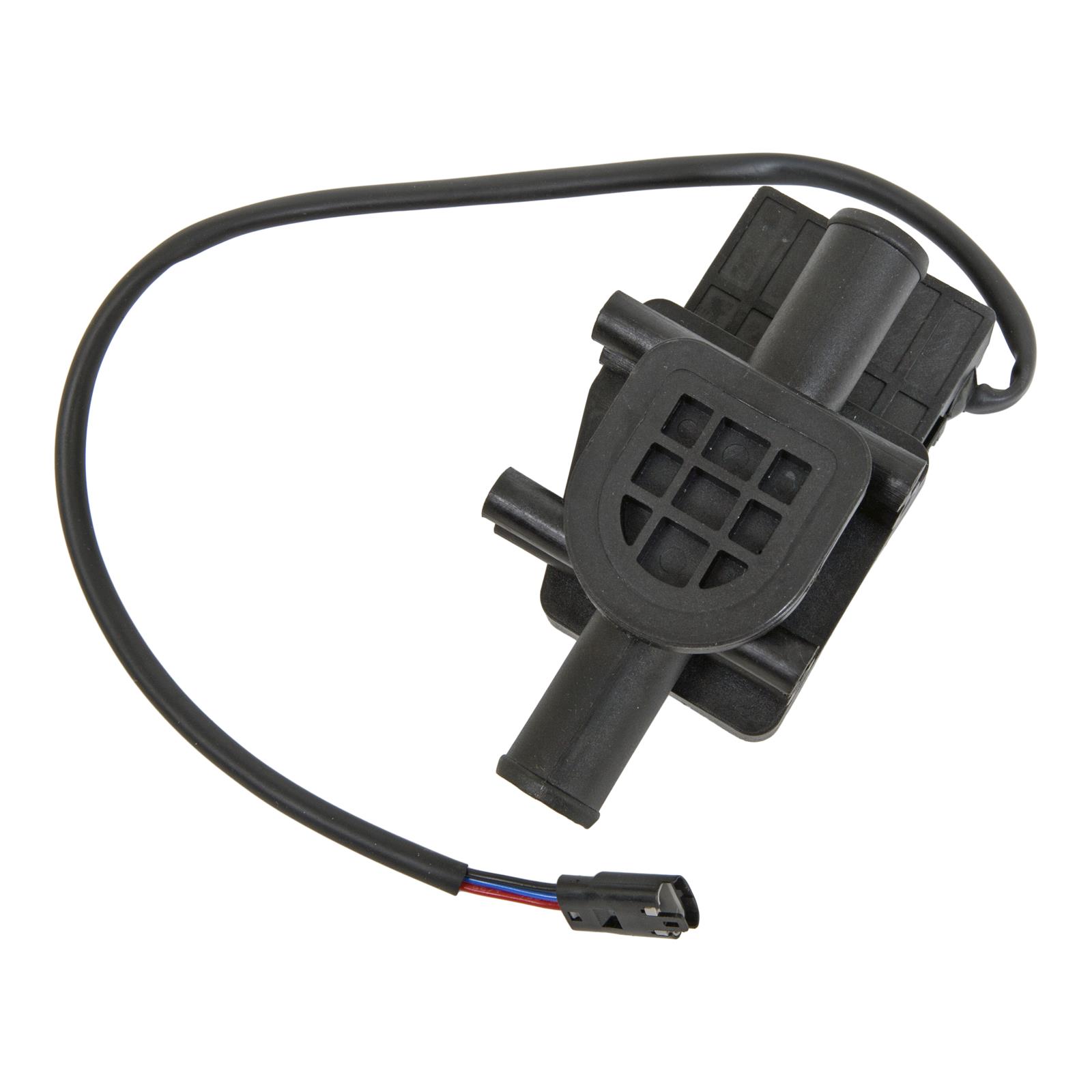

I'd probably go with this one, as it's specifically designed to control coolant flow to/from a heater core - so I doubt it'll melt down:
Simple 3-wire hookup - black to ground, red to a switched +12V supply, and blue to your in-cab switch (which is also wired to a +12V feed).
And it uses 5/8 heater hose which makes it even better.

Thanks for the replies, I was trying to find one the UK to avoid import, its probably best Summit isn't in the UK or I'd have bought an engine for a reject car and all sorts by now :D
