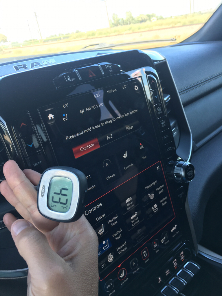

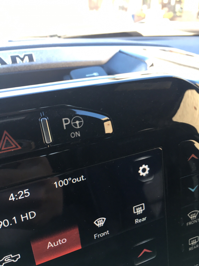

Put the clamp on the other day. Before i did it on a 100 degree day I couldn’t get better than 53 out of driver side vent. After the clamp it was down to 43!

Did you do this by feel only or with a thermometer......it would be interesting to see the different thermometer readings and the spread between the 3 trucks (and, I assume you had all 3 set the same way - recirc, top vents only, fan speed, etc.??)
