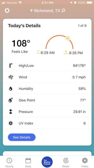

It is kind of a shame, but today I rode home with 40 degree drivers side vent temp, outside temperature on the truck
said 90. A couple of weeks ago my rear passengers asked if I could make the AC not so cold, they even had the rear vents turned off.
