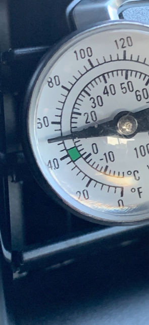

This is my stock passenger side, 97 at the time, in Florida. I think I will be doing this mod as well.

When I first put the clamp on, I didn’t completely close off the hose and the temps really didn’t come down. I then tightened the clamp all the way down, and the driver’s side front vent now blows about 44 to 45. Before clamping, it blew about 52 to 53 degrees.

If you have the valve, then dont completely close it. I just have mine sort of clamped that stills coolant flow, and I still get 40 degree vent temps AND hear.
This Morning it was kind of chilly, My heater couldn't warm up, it was trying until i figured out and just lowered my Auto setting so the truck would stop trying to warm up to 72 degrees. So no your heater won't work and I have the valve. I am alright with it until september when it cools down. We are looking foward to 110-114 degree weather here.
only down to 54 degrees. were you driving or sitting still. Was that on regular a/c or MAX?
I still get a little over 40 consistent driving.

That’s a great number. With mine clamped, I get about 44 degrees out the center, driver’s side vent. That works fine here in Central Texas, although we haven’t yet hit 100 degree days. Before the clamp, it was about 52 degrees.
