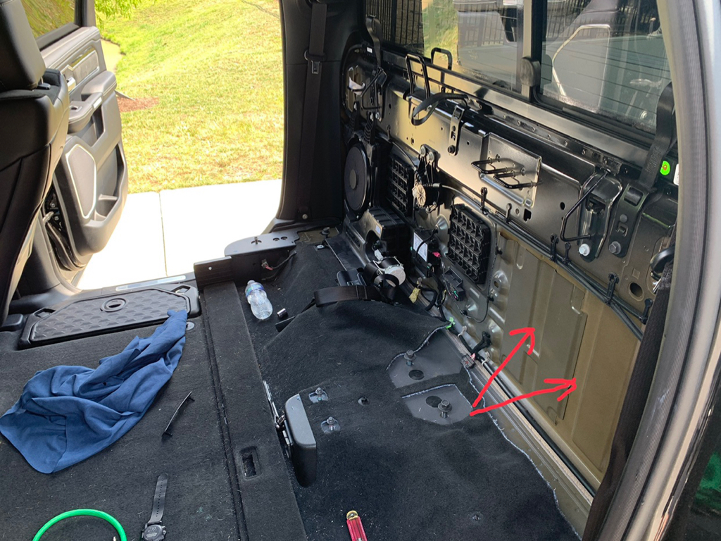

In the middle of my install now. 100 degree heat today made it a pretty sh*t job, but was able to get the rear seats and rear wall carpeting removed and run the power/ground/remote wires. The temps had melted the glue holding the back wall sound deadening rubber mat in place, so I’ll be correcting that before getting everything back together. Trying to decide between the AmpPRO or LC2i for the interface. Having a local shop build the box for me since I don’t have a good place to do some woodworking. Installing 2x RF P3SD2 10”s and a RF 750w amp. More pics as I get it all put together
In that slightly recessed space on the right, I'm planning on buying a piece of plastic. If the seats are still out, do you mind giving me some measurements of something that would fit real good, with a little gap?
I had great success adding noico 80 mil sound dampener and the noico green closed cell foam. There was also room to hang a sheet of MLV on the back, but not enough to room to hang in the doors. Now I have a huge roll with no use at this point.
Maybe one day I will pull the seats and carpet again and door the floor.
You talking about these recesses?
I wouldn’t mind coating the back wall with something while I have it disassembled. That’s usually where I hear rattles from even with the stock system.
The only rattles I hear now are at very specific frequencies on the interior door pillars.
I'll take a crack at that one day. My truck sounds so good that I get goosebumps sometimes.
I was thinking something like what this guy made. Got it from the facebook page. Just from estimating, an inch more at the top, 3 or 4" at the bottom, and 1/2" at both sides? I have a couple amps, and hoping I can fit them both on that 1 side. JL Audio 900/5 and an Alpine S-A32F. I think it was 105 here today, so just trying to plan this out to do when the temps get cooler.
