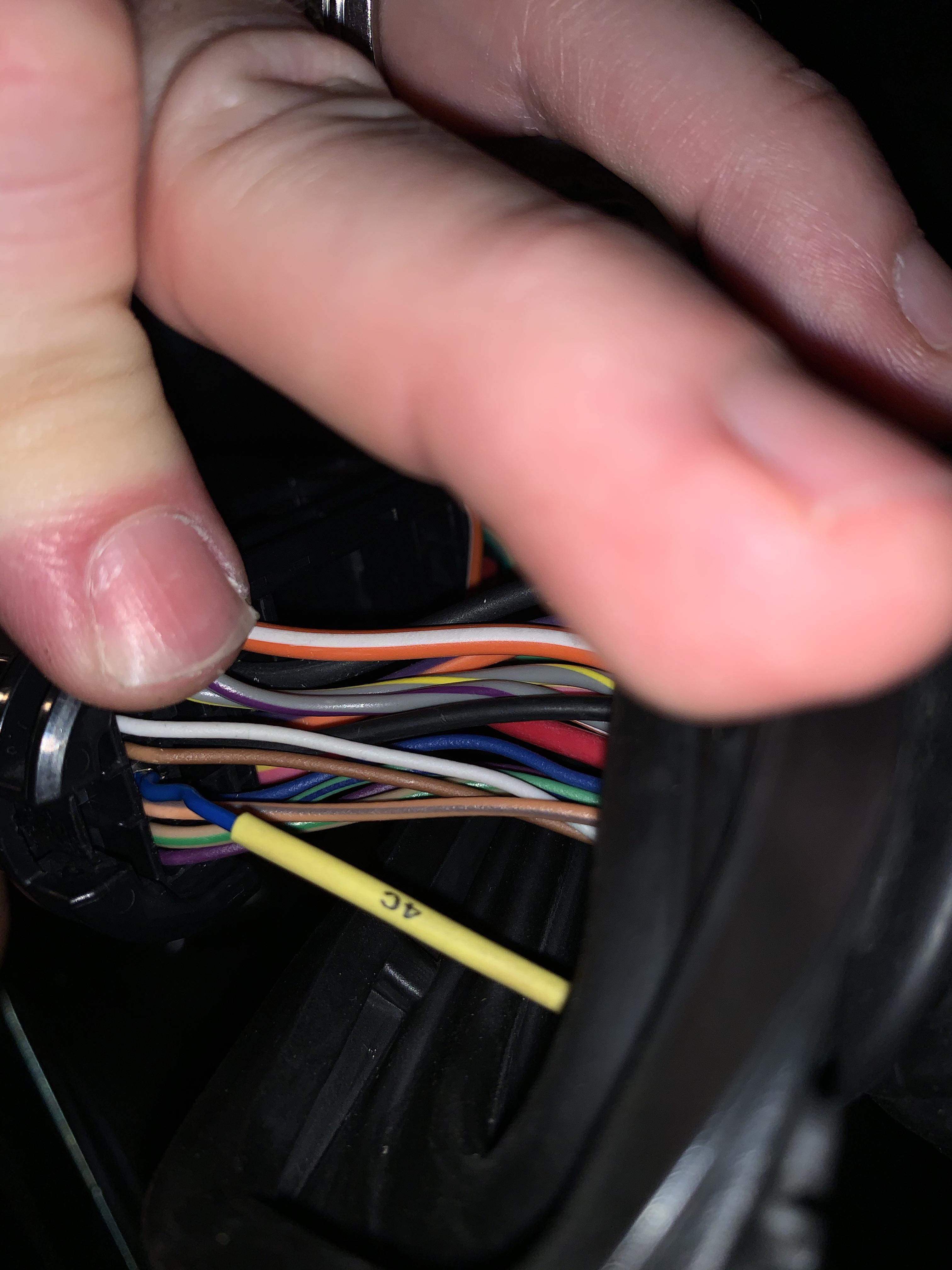

So I received a passenger door cable from Jimmy and the pins are labeled for a 1500 (i.e. 16D and 17D). I have a 2500. Can someone please tell me how those translate to the pins on a 2500. Should I place the 16D pin in the 4C or 14D location? I have the passenger door taken apart right now so if someone could answer me soon I will be eternally grateful :)

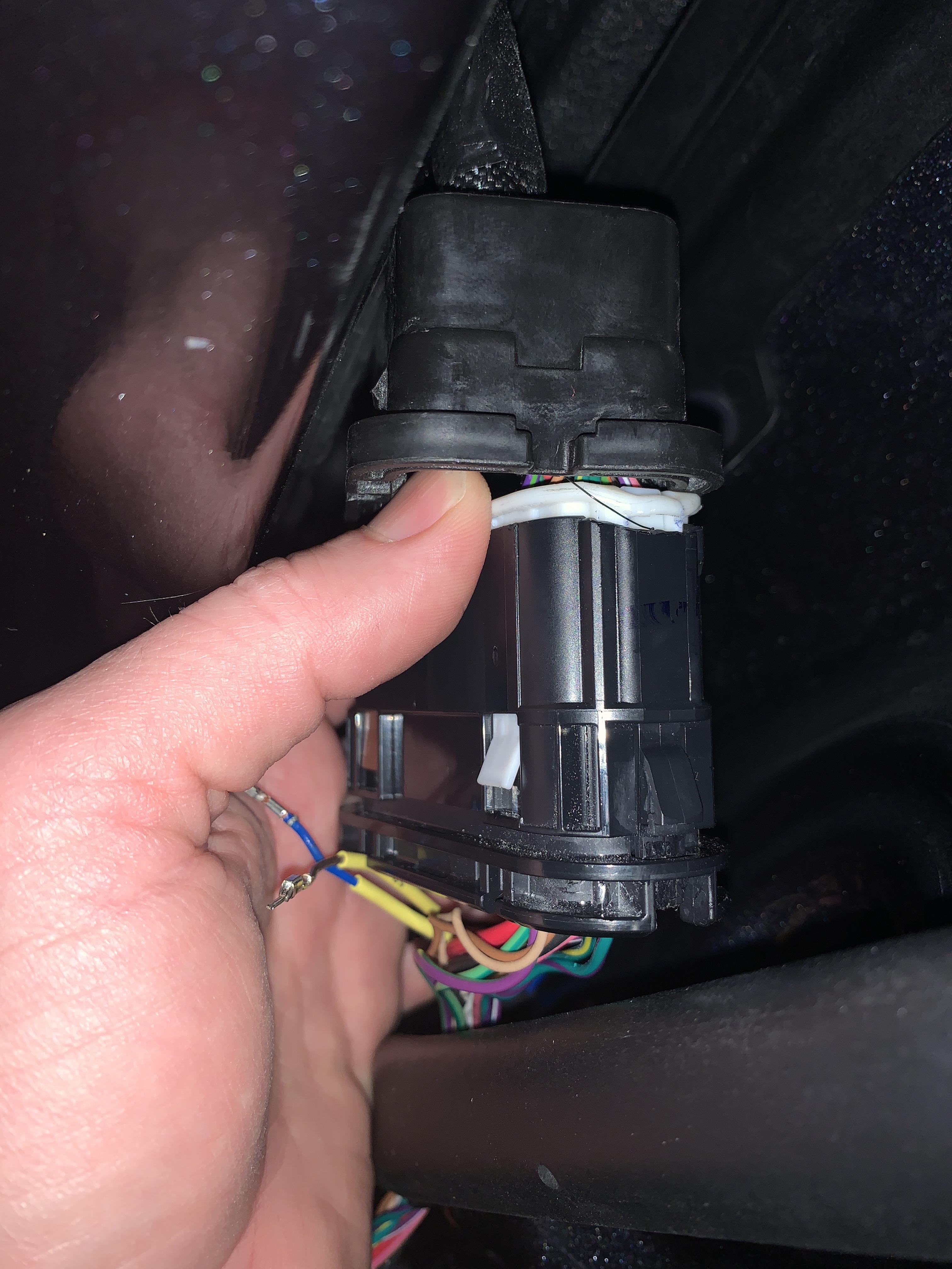

Question. Do I need to unplug the back of the door connector where my thumb is to be able to release the tabs that will allow me to inset the pins or do I just need to lift the tabs on the side while inserting the pins?
You need to unplug the individual white and brown connectors that come from the cab from the big door side connector in order to insert the two wires into the big door connector.

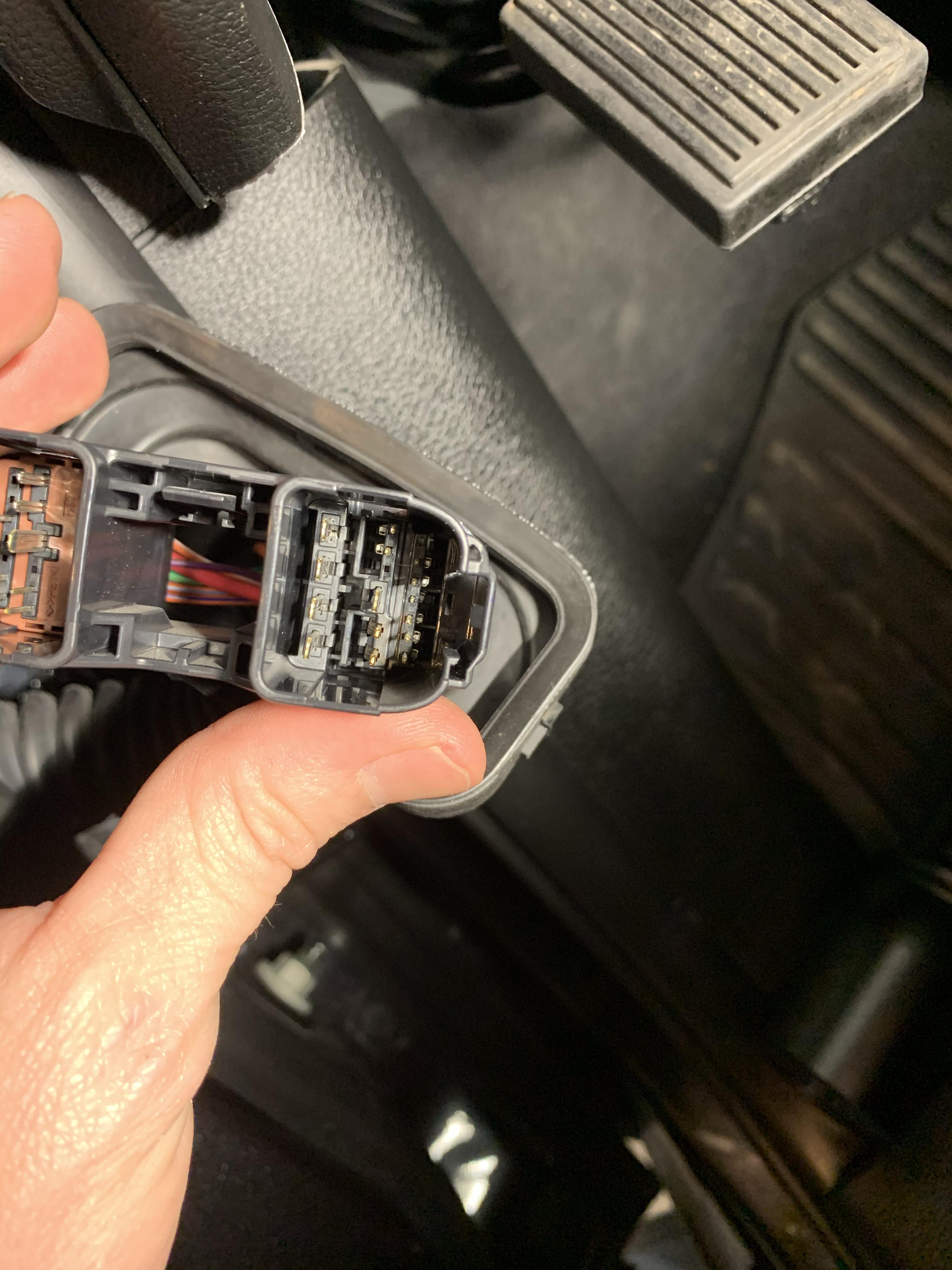

Once the connectors are unplugged, you will use these tabs on each side of the connector to raise the locking face (inside the connector) up about a quarter inch.
