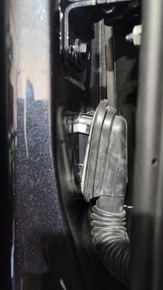

Also I'm trying to get the boot off from where the door meets the body but it's nearly impossible. Sliding a small screwdriver down to unconnect the tab doesn't work because there's a tab on the opposite side that you can't get to unless you take the entire door off.
Am I missing something here....I see there's one tab up top and there's one down the bottom however that does not release it as there is a third tab that is on the opposite side that you cannot get to
Use a right angle pick on the bottom where the tab is on the backside.

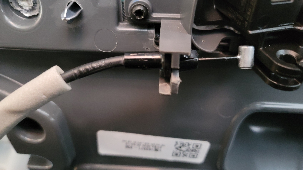

Holy hell....sorta a short handed nightmare at the start. Once you get the first one done it's alot easier for the other side. Broke one clip that holds the inner handle cable in place ..... Very thin plastic.... thankfully the part is only $30. Jimmy rigged with a zip tie for the time being.

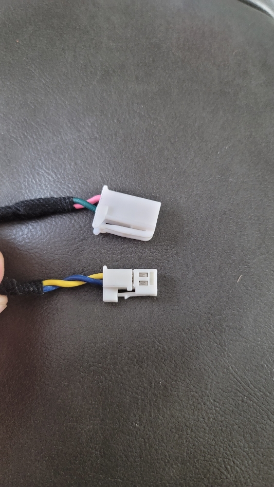

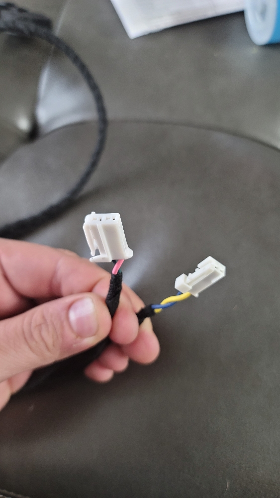

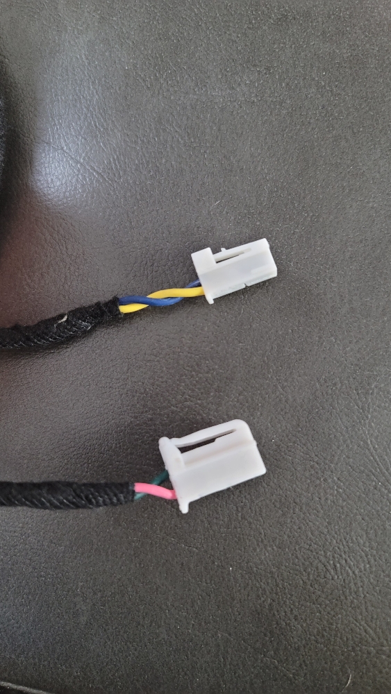

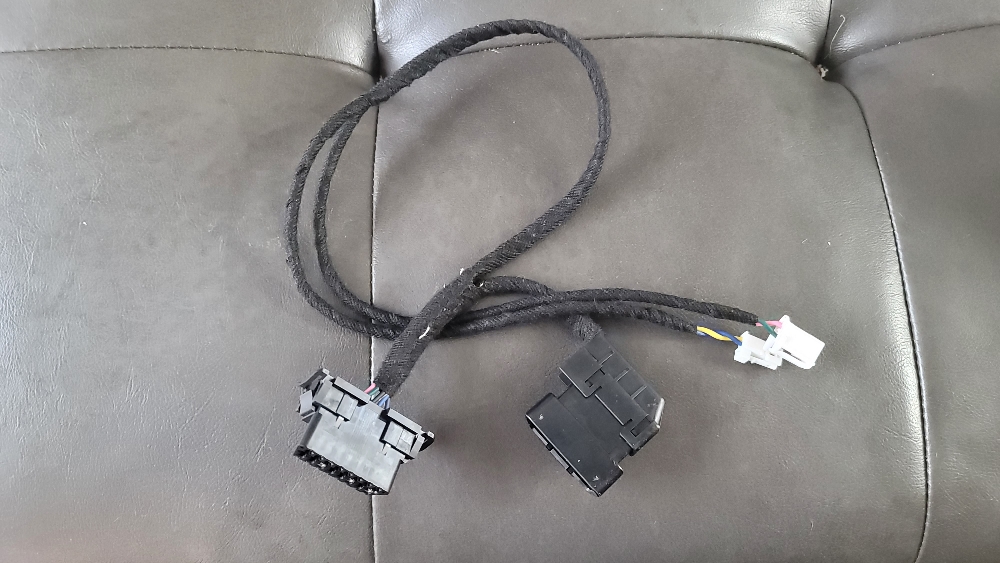

Would have been a good day, but KAOD sent me the wrong cable.
What other bypass cable can be used? Does anyone have one other then this one?
Which one did he send you, can you post a pic of it?
They sent the classic one by accident.
Haven't been able to get a hold of them, so may try a different one. Any suggestions?
What's the difference between the KAOD cable and a SGW Bypass?
That’s why I want you to post a pic of the one you received. If I can see the two connectors, you might be able to make it work.
These are the pics
These are the pics
Go ahead and try making the changes with only this one plugged into the junction block that it fits in-
