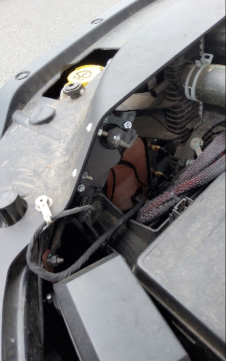

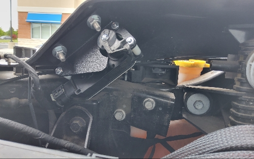

Okay I'd like to update everyone the vice design bracket that they make for the EcoDiesel lower grill shutter but we don't have on the 1500 DT works perfectly for the radiator grill shutters on our trucks you take the AGS actuator you bolt their little bracket onto it, cut off a part off one louver stick it into the actuator drill through it put a bolt in there to keep it into the actuator motor. Bolt the whole kit together (I would advise to use a little bit of thread lock) and then you can mount your AGS motor and new bracket wherever you'd like. I had to clear codes in the beginning and then it came on once more so I cleared them again and after that I believe the computer learned itself and I had no issues. It's only been a day and a half but the permanent stored code went away as well. I mounted mine to the plastic radiator trim or whatever you call it probably more well-known as the beauty cover
