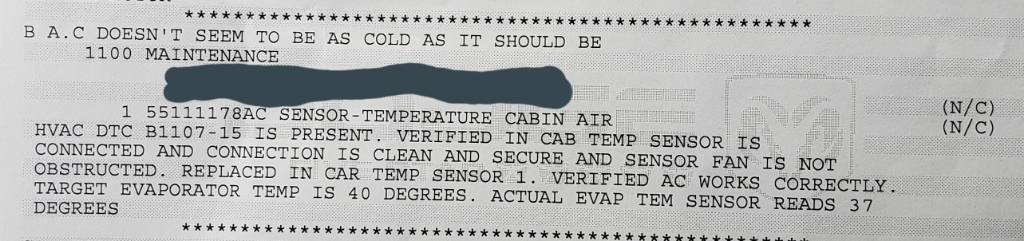

I felt like the AC was not functioning properly...the air stayed too warm for my taste and still felt a bit humid, so I took it in. Techs say it was a malfunctioning temperature sensor. Solution was to replace.
When the part came in, I vomited every bit of the forum armchair theories and solutions I could remember. He nodded his head and said they are aware of all of that. I was like Roger that!...do your thing then maestro.
Long story short, they were a friendly and seemingly competent lot, but this did not improve much based on my "feels". I agree with riccnick in that their tests have verified that my system is operating as designed, however, the 52 degree vent temps at 80 degree outside temp, and, my comfort level invalidates this design as working well for this user.
