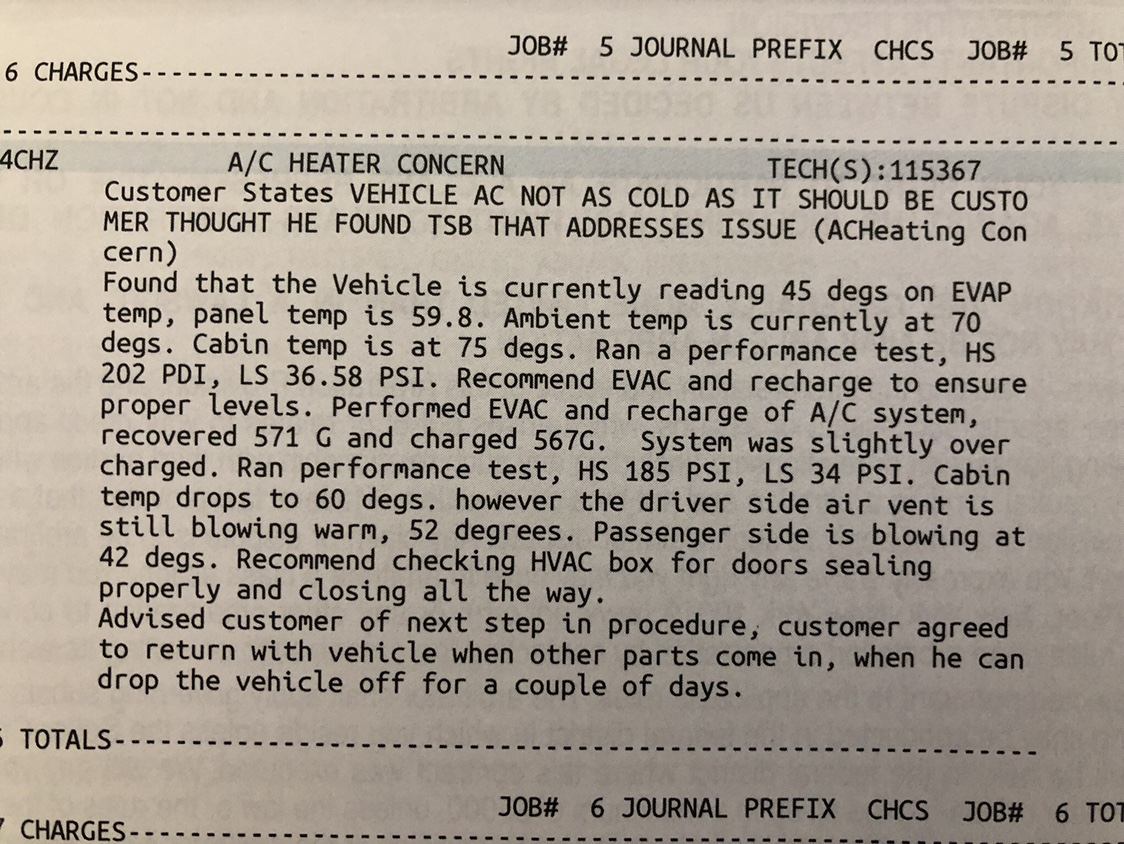

Here is the summary from the tech that worked on mine. Definitely not about to have my dash torn apart for no reason.
