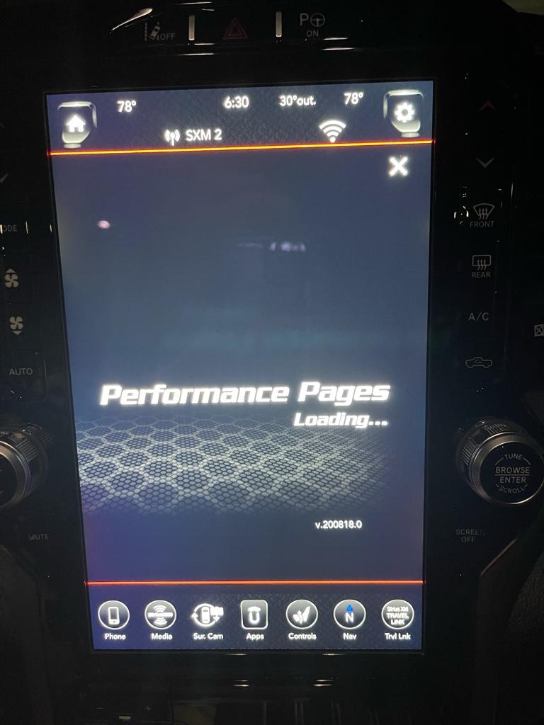

Installed the the PR39.7.0 update... no backup camera YET.. gonna give it a nights rest see what it does.. im debating if i should do a ln ECU(radio) Reset....

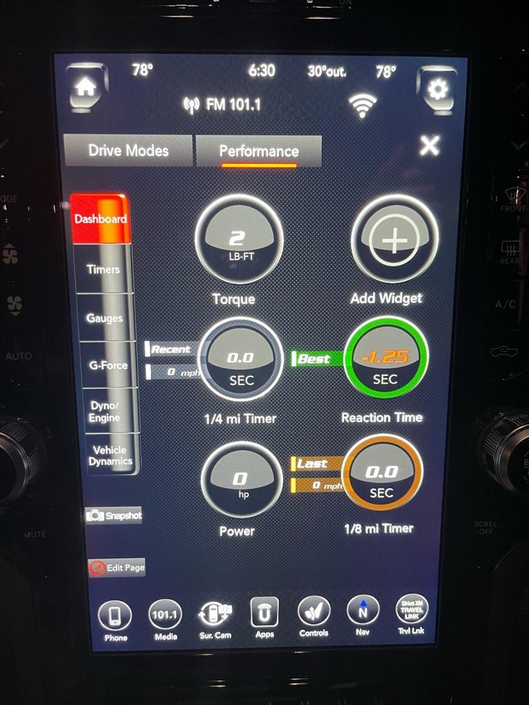

BUT... I am HAPPY report the Perfomance pages! MAN THEY ARE SWEET!!!(very similar to my wife's 17 Daytona) but i REALLLLY hope the back up cam works later on! Attached are pics of the performance pages!
the pages work
the pages work
Ten four! (Yes) some things dont work like "drive modes" cant change my steering seeting to sport or comfort.
I have not tried the LAUNCH CONTROL as i do not race or have a need for speed (anymore jijijiji).... but the TOURQUE, ENGINE HP, the GRAPHS, the timers they all work.. its actually a pretty cool screen to have on display instead of the NAV or SIRIUS radio being on all tge time...
I installed the PR39 update and don’t see performance pages. I noticed in one of your screenshots it says it’s installing the .jar file. Can you tell me more? Is it a separate file to install from a usb drive?
You need to enable them with AlfaOBD
Below gives you the off road pages and performance pages.
VehConfig 1-Performance Pages Present = YES
VehConfig 2-Off-road Capable =YES
VehConfig 5-Off-Road Pages Present =YES
Awesome thanks! Going to try now.
Probably need to wait for it to show, mine took about one hour.
All i did was install the PR update.... in the files there is a "MAC OSX" file... i did not include that one in there because i tried 4 times to do the PR update with both files on the USB.. when I re-downloaded the PR update for the 5th time.. I only extracted the PR39 and moved the file to the USB..... not the MAC OSX file... I inserted the USB into the RAM's port/media hub and it worked... AFTER it's 20-30min install, I noticed at the bottom some small script displaying several things "INSTALLING THIS.THIS ETC ETC...." THEN I saw "INSTALLING. PERFOMANCE PAGES... 😐😐😒😏😏🙄😁😁😁.. and NOW I have performance pages!

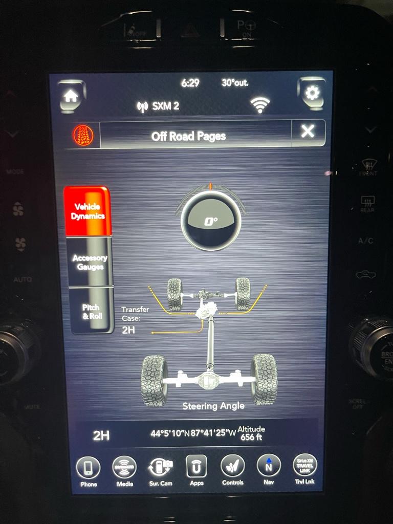

Hi, is there any more updates like navigation, etc. thanks.. also thanks for the update went smoothly just have two off-road pages. One works other doesn’t any idea how to remove non working one? Thanks
