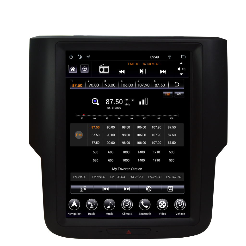

Linkswell makes a 10 inch conversion kit called T Style Radios for Rams. They make a great 12 inch conversion for Fords too. I have one in my F-150. The install to replace my small screen with a 12" screen took about 30 minutes and all connectors and converters were included in the kit, with very specific instructions and videos available.
I did not see a year or specs for your Ram in your signature, so I do not know if the one linked below will work for you. I believe it fits for 2014 to 2018, but Linkswell does update its catalog often, so you may want to call if you have a 2019 or 2020, or see if there is a 12 inch system and kit available and to find out if a conversion kit is available for your specific Ram.

Linkswell, Phoenix, “Tesla style”- they’re all the same rebranded radios. If you don’t mind fiddling around with them constantly, or having features on the truck not working the way they’re supposed to through the radio, most people overlook that stuff because “at least it looks good”.

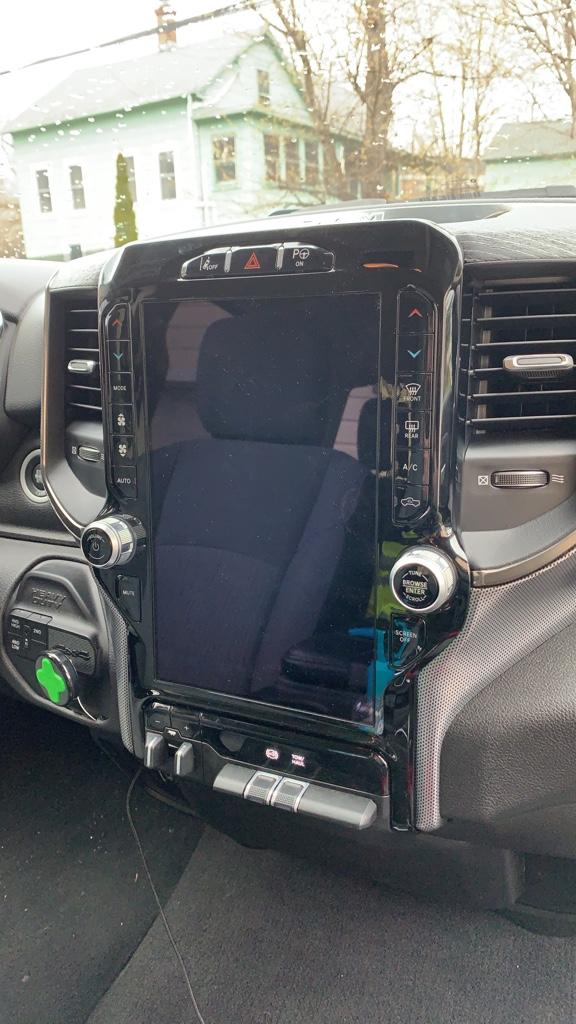

That looks Good and a heck of a lot more acceptable than me having to deal with the red accents (lol)
