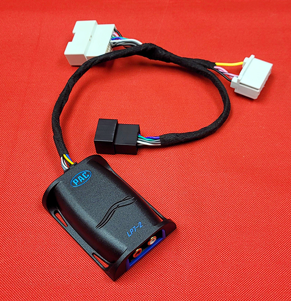

noice! Im adding a SSL 1200W LoPro10 under the drivers seat. They recomend pulling signal from RL speaker wire. Seems odd to me. Best location to get signal? And with the wires removed as the video says, I don't need to get any bypass or other filter?? Ive never done stereo install stuff on a vehicle this new...but it is mine so lets do it!

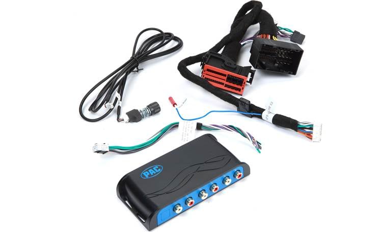

Try purchasing the PAC ANC bypass harness first you will not have to disconnect the mics and can tap into this instead of tapping your factory wires. This is what I used on my 1500 to grab signal, power and ground for my LC7i.
Should I just do the Pre Amp? the amazon version is $249 but says 2013-17 dodge:
but the crutchfield is $315 and has an additional harness (2nd link):
and...............
so i'm not sure what i need just for my install and what would be needed if i want to add on? Just the bypass harness you gave the link to lets me do what? sorry. just trying to get clarity so i can order what i need for my appication!

do not buy the Amazon one. It’s not compatible, it’s for older models only. If you get the PAC interface, you need the .R2 model with the extra harness - so only buy one that specifically calls out ‘22 models and newer.
if you’re only adding a sub, you don’t need the Ap4-ch41. When I initially added just my subs, I just added a line out converter, and pulled signal from the existing sub wires (Alpine system). the bypass he showed you cuts off the ANC, which is mandatory if you add subs, or you get horrible noise.

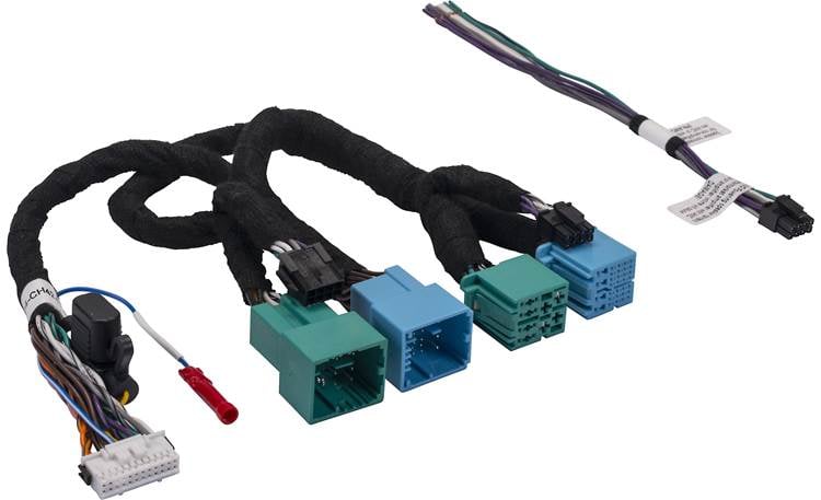

heres another, easier option. Do you have the base (6 speaker) system? Or do you have Alpine/HK? Net Audio makes fully integrated harnesses, all you have to do is plug them in, then plug in your amp/speakers. Link below for the one you’d use if you have base system

ok, so that one I linked would do exactly what you need. you plug it in to the ANC module, and it gives you a signal out to your subwoofer amp, using the LOC that’s included
$25 for a bypass but $124 for one with RCA outs? Anything on amazon work the same?
you need at least the anc bypass (or cut the wires to bypass the anc), and a line output converter. You won’t find something exactly like what net audio has on Amazon, since he designed and makes those custom for the Ram, but if you know what you’re doing, you can diy it a little cheaper.
