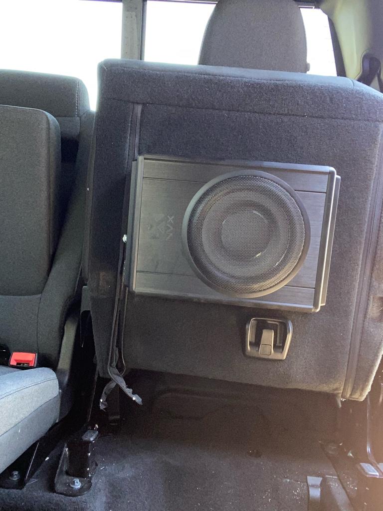

Original plan was under my seat, but since the giant seat has no room under it here will do.
