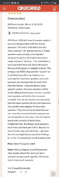

This is a 6x9 component speaker consisting of a 3 1/2" tweeter and a 6x9 woofer. Would I be able to install the woofer in the front door and the tweeter in the dash? If so, would I need to utilize the crossover they provide, or could I just install them using the Metra harness? I have the stock 6 speaker system with the 8.4 NAV and the ANC module under the driver's seat. Thanks for any insight.
Kenwood Excelon KFC-XP6903C
Assuming that there is no major difference between the 2019 classic and the DT I think it would fit and be a great idea. Pay attention to notes for the wiring on the install in the review below.

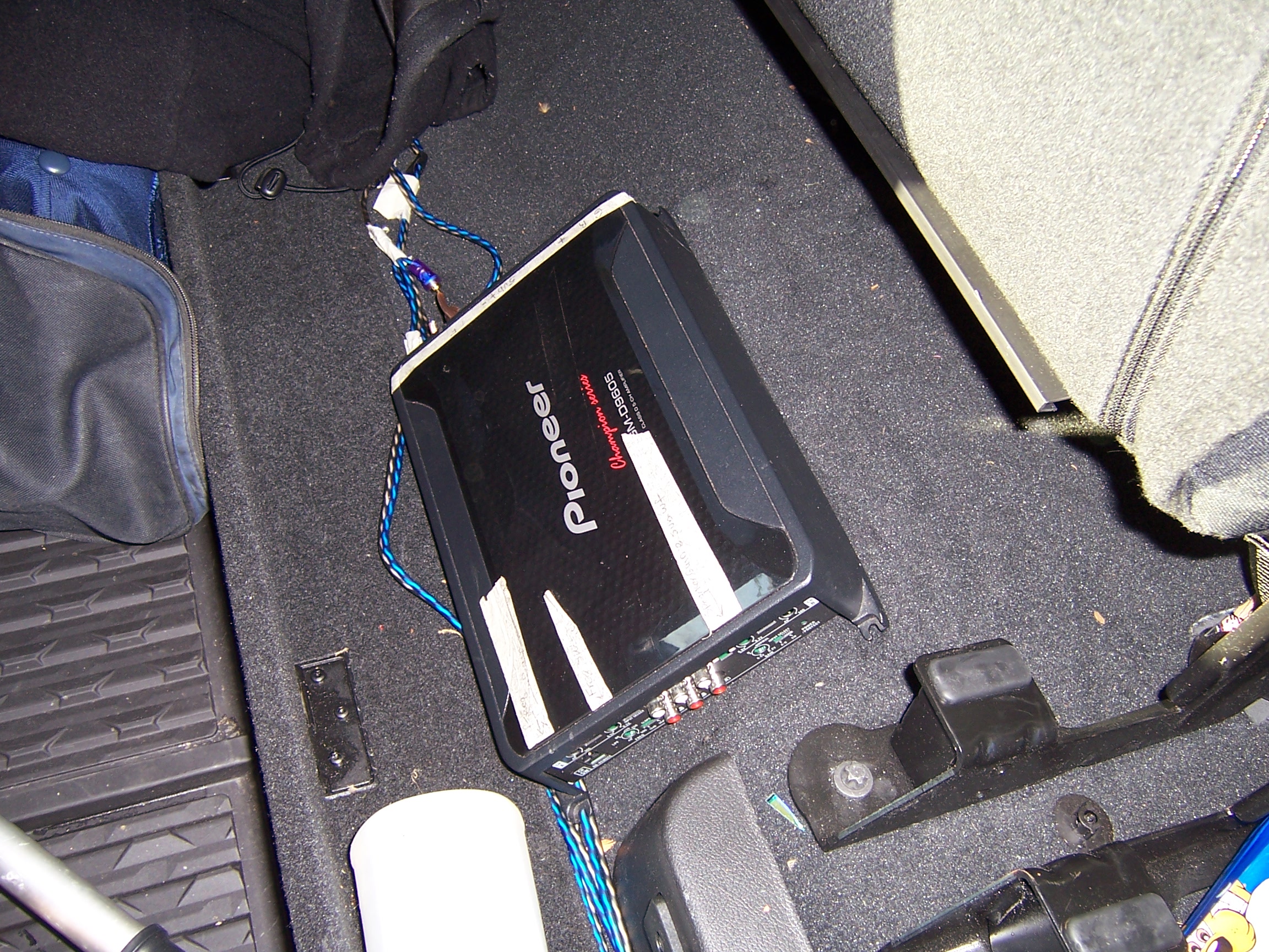

you know your right.i took you guys advice and not touch those switches.it still played with no problem.i have not conected to my amp yet.truck right now is getting "Ceramic coated".so what i did for now.is just playing it thru the stock setup(Alpine)works just fine!.no static,error codes.etc.just have to install and secure the amp..here is where its going guys .
