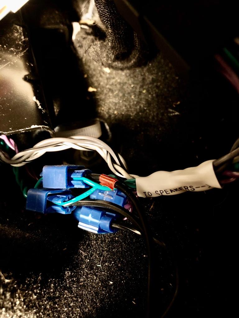

Do you have a pic of the PAC harness under the ANC and where you tapped the wires? I'm guessing I tap into the speaker wires that plug into the ANC then connect them to the PAC-CH01and plug it back into the ANC?? I got everything on the way so it will be easier to figure out when Its in my hands. First time doing car audio so forgive me for sounding like an idiot. I ordered the PAC-APH-CH01 but hopefully it will be plug and play still.
Here’s the CH01 with a sub add. I used the blue taps to grab signal from the rear speakers. In this case, if you are running an amp to the rears there would be no blue taps, just cut the wires and run to your amp and then run amp outputs back to the harness where ya’ cut. Super easy once you see the CH01 harness.
