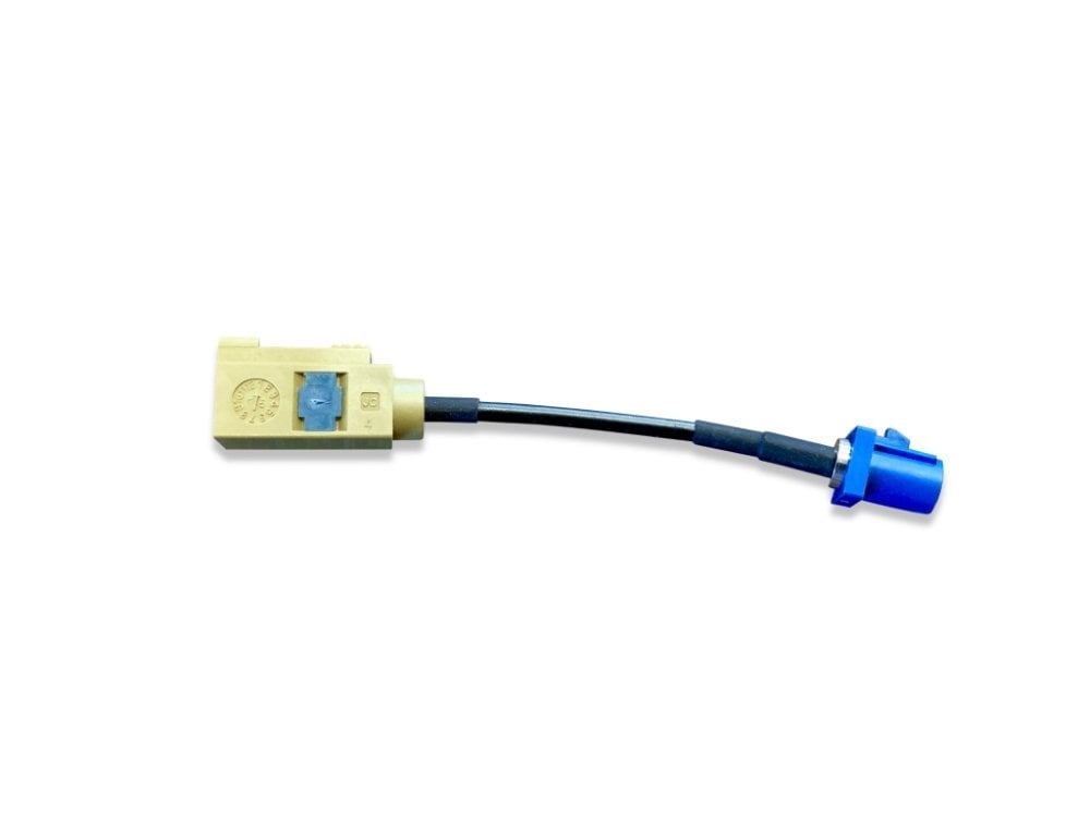

Yes, the non Nav 8.4 is plug and play. I did not have to reprogram anything. The only thing I did was resent the radio to factory settings. I forgot to mention on my post that you do need a conversion cable to be able to use the gps antenna (for Android auto or carplay map apps) used for the factory 5 inch compass. I actually bought the siriusxm antenna that comes with a splitter, but if you dont care about the satellite radio you can buy this.

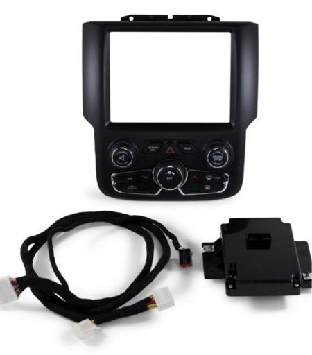

So just wanted to give you guys the updated pictures after I received the new bezel today. Everything works perfectly. Next step I'm going to ask the dealership if they can load the app to control the heated steering wheel from the screen. Let me know what you guys think.

The numbers you sent were correct, however my bezel is different from the one you purchased. I need this one. I can get the bezel from eBay for cheep but I need that climate control module. Do you know where I can get it from other than infotainment.com?
That bezel is for a 4th gen, which includes 2019-2020 Ram classics. If that’s what you have, then none of the info in this thread applies to you. The UAV radio can be made to work on the 4th gens with some BCM settings changes and modifications to the back of the bezel. The UAM radio is a red headed stepchild made by a different manufacturer, and won’t work in a 4th gen. You would want a UAS or UAQ radio, a conversion harness, a different media hub in the center console, and the HVAC module.
