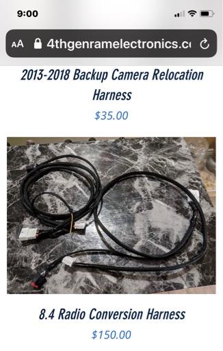

So I originally posted in the wrong forum, my 2020 Ram is a forth gen. I had to buy a control module and the harness. I got the climate control module from EBay and the harness from a site called 4thgenrameletronics.com

First off, let’s clear this up about Infotainment- it is a flat out lie when they say that they program the radio to your truck’s VIN. Sadly, it is those like you that they feed off of, to make think that their overpriced kits are needed. I can assure you that all they do is buy radios out of wrecked trucks, make sure they work, and turn around and sell them. This thread has pretty much all the info you need since you have a fourth gen- https://www.ramforum.com/threads/how-to-install-a-2018-4c-uaq-uas-radio-in-2013-2017-ram.116140/
Basically, you need the radio, bezel with HVAC controls, the HVAC module, and a conversion harness.

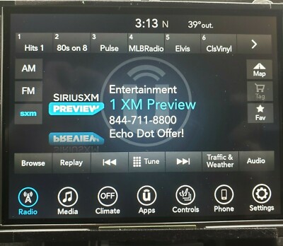

So let me start by saying, this can totally be done and it’s pretty much plug and play. The main reason I got the upgrade was for CarPlay. The bigger screen is awesome, you can actually see where you’re going in reverse. Lol. Don’t buy your radio from infotainment, they are the biggest rip off, I got the radio from a reputable seller on EBay I did provide my vin to them. When I plugged the radio into the truck it learned the features of the truck on its own and you don’t lose any of your current features. If you’d like I can tell you where I got everything.

This is the same exact radio I bought for my 2020 warlock. Your satellite, backup camera and everything will work. I got the control module, bezel and wiring harness for half the price infotainment wanted.

Yes I got the UAS 4C. You do need to order a usb hub, got an exact replacement, no cutting or weird size. The new hub supports CarPlay. Make sure when you buy the climate control module you get single zone.

Sorry about that, I tried to post pics of all the parts and numbers. Get the hub from www.allmoparparts.com when checking out put in code 5OFF
#68328704AC. the Bezel came from Quirk, EBay# 5VD75JXPAD. climate control module(Ebay) #68366552AA. go onto 4thgenrameletronics you should be able to find the harness pretty easy. You can search the part numbers on EBay. Let me know if you have trouble finding anything.
