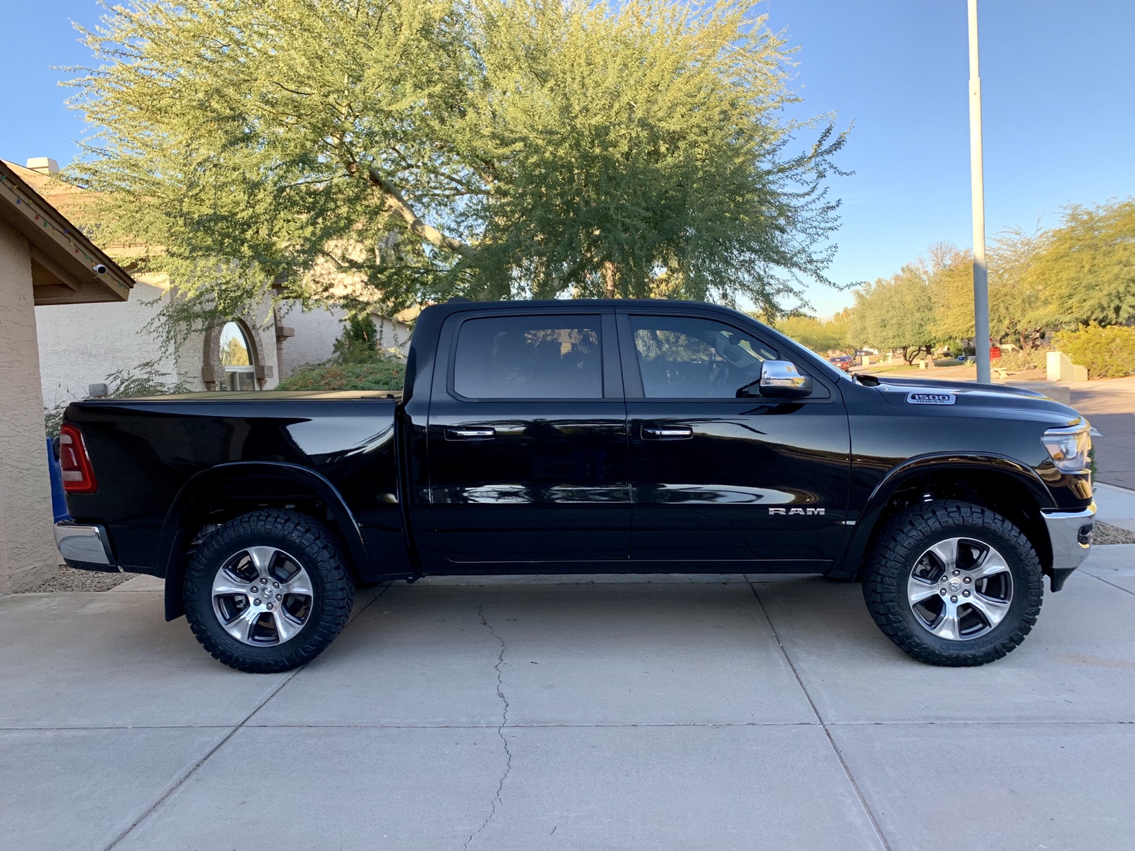

ReadyLift 3.5 installed and 35x12.5R20’s on stock rims with a 1/4 inch spacer. Hopefully wheels drop on Friday for the weekend. I’ll post some better pics in the morning when the sun is right and the wife’s minivan is out of the way. Just finished putting in the LED’s in the Cargo and Third Brake Light, put the Pedal Commander Back in and put my BakFlip back on from my last truck.

ReadyLift installed and 35x12.5E20’s on stock rims with a 1/4 inch spacer. Hopefully wheels drop on Friday for the weekend. I’ll post some better pics in the morning when the sun is right and the wife’s minivan is out of the way. Just finished putting in the LED’s in the Cargo and Third Brake Light, put the Pedal Commander Back in and put my BakFlip back on from my last truck.
That’s the 3.5” kit or the 2” level?
3.5 Inch Lift. I’ll post some side shots and before and after tomorrow. Sun was going down and the wife’s van was in the way.
I like this
So the measurements probably aren’t exact because it was dark but what I ended up with was pretty much right under 42 inches from ground to bottom of the wheel well at midline right through the center of the wheel all the way around. Can I expect some “settling” in the front? I was hoping to still have about 3/4-1 inch of rake left so it didn’t look “stressed” when hooking up my camper. I don’t tow enough for me to be overly concerned about it but in case it grinds on me and it doesn’t settle in a bit what would my options be? Larger Spacer in the rear, Airbags, other?
Here are the measurements I took in the same spot in my driveway.

After ReadyLift 3.5 and Nitto RG’s 35x12.5R20
Front Driver 41 7/8
Front Passenger 41 7/8
Rear Driver 41 7/8
Rear Passenger 41 7/8

The best way to determine whether there will much settling is if you measure from the center of your hub face to the center of the lip on the fender (Straight up from the hub). This way you are only looking at the lift affected by the suspension and not a combination of tire and suspension.
Makes sense. I am at about 450 miles.
