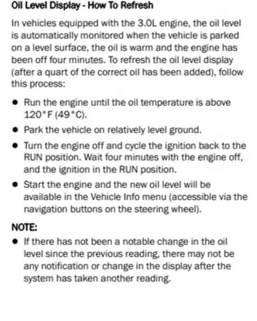

Not a CEL post but a PS announcement. If you change your own oil, a certain criteria must be met before the oil sensor will read correctly. I’ve done 3 changes now and have just recently discovered that I wasn’t checking the oil level properly. Here ya go. Unless you already knew. P.S. truck is running great after the flash, 1,300+ and no CEL. Also wanted to mention that it only reads the oil level during this time, my understanding is that if you drain the oil while the truck is running, it won’t show the low level until this criteria is met.
My Oil level never seems to budge despite my exhaust tips turning black a day after cleaning them. Direct injection engines do make more soot but I'm alway's thinking the truck must be burning oil even though the meter says it's not.
wtf that's crazy sit for four mins in run position lol. I did not do that at my 1800 mile oil change will do today.Mine has always been at top of redline near max before and after oil change . i know its quiet i know its faster but ugh. New front end on rebel and the new dash is the only thing i really like. O and the automatic close tailgate.
off road pages will tell you if you are on level ground for oil check for anyone that has that option.
