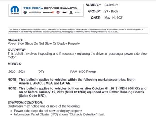

Not sure if it applies for 2500s, but there’s a TSB for the power running boards.
I know this is a really old one but having issues with my 1500 limited passenger side step locking up both on extending and retraction. Truck has less than 15,000 miles on it, acts like it's binding up or just doesn't have the strength needed so the system just rejects it in the opposite direction. Anyone have any luck at the dealership?
