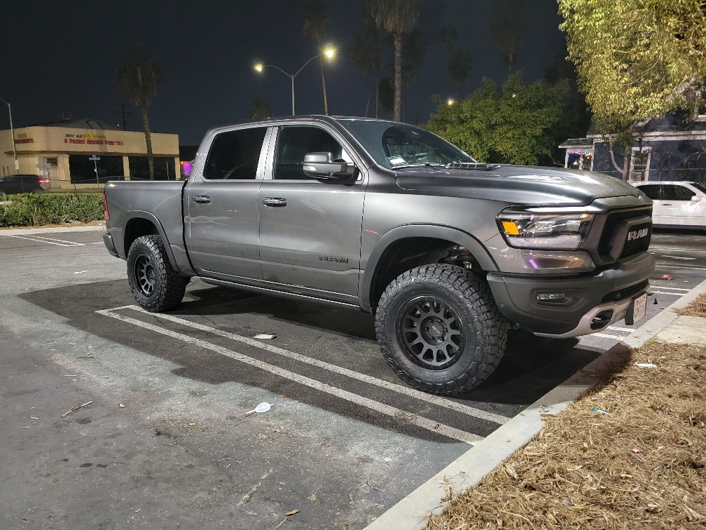

It's not as floaty, it seems more controlled. My tires are firmer than oem so that's also a consideration. It's still a very nice ride and I was pleased with the outcome.
Just got my tires in and installed on Friday!
2021 Laramie Night edition with a 2” level and 285/55r22 Nitto Recon Grapplers.

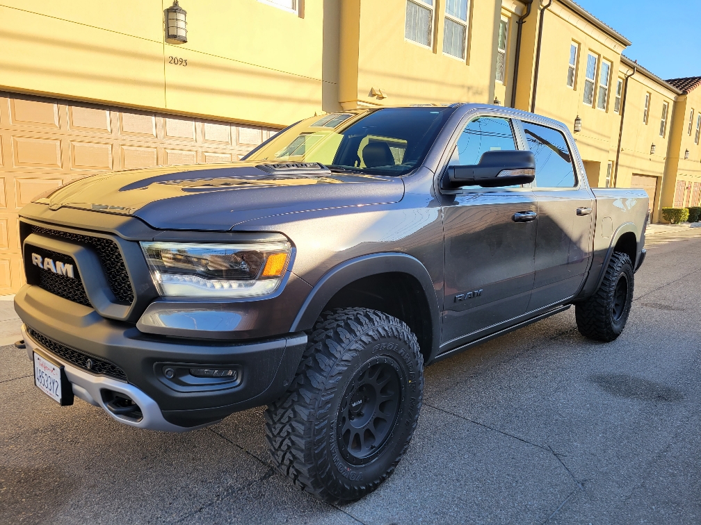

Rough Country 3.5” lift with loaded struts and upgraded V2 shocks. 295/70-18 Nitto G2’s. No rubbing , rides great.
How are the 3.5 loaded struts holding up? I am thinking of going that route instead of the Readylift 3.5 SST with Bilsteins 5100 I currently have. The ride is not that great right now.
