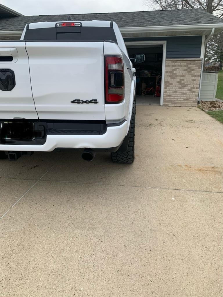

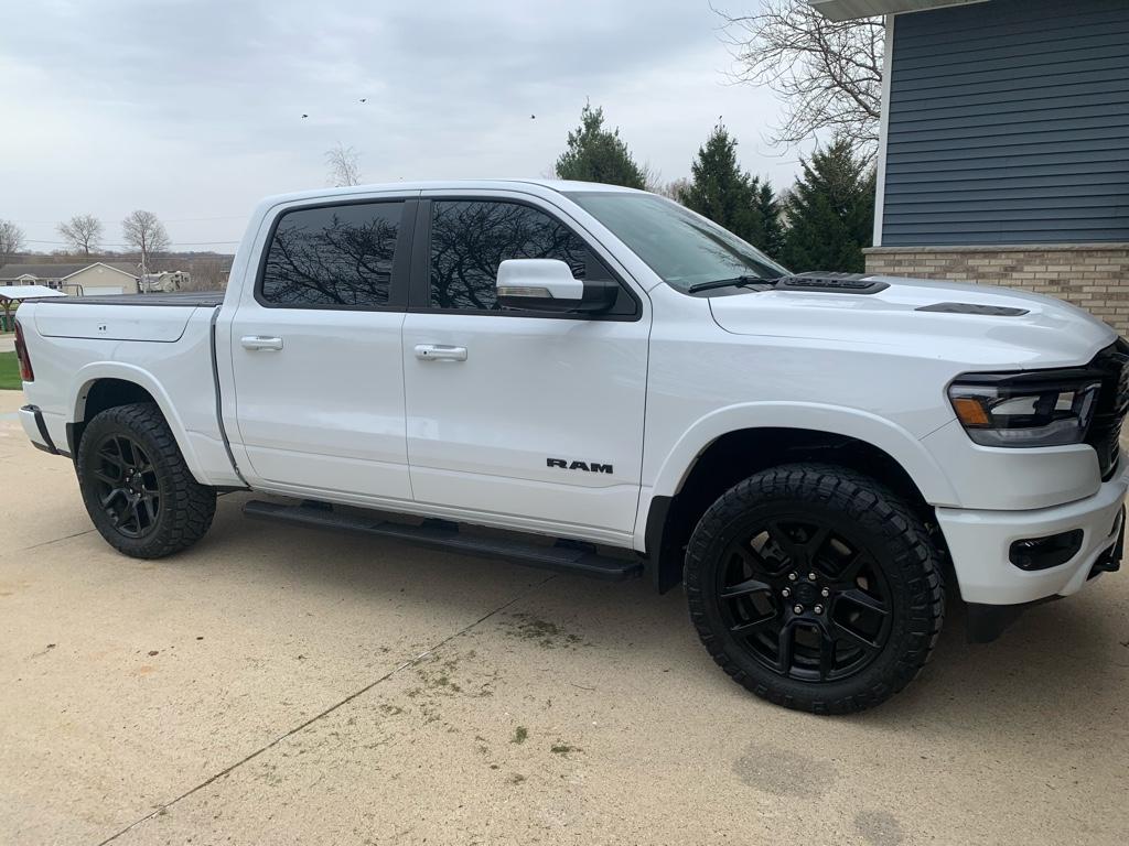

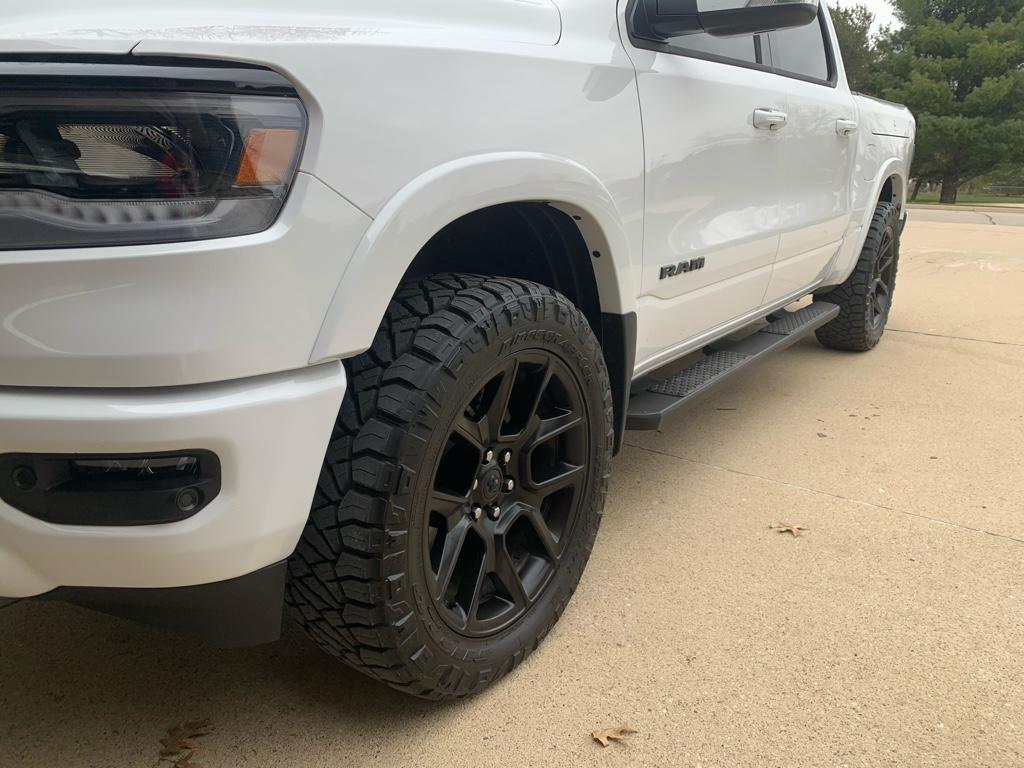

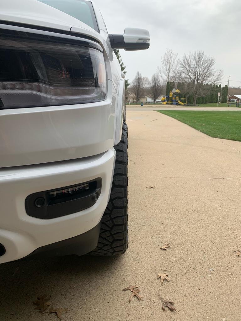

Finally got mine done and happy where I am at. 2” ready lift level kit, 285/55R22 Ridge Grapplers, 1.5” bora spacers in the rear, 1.25” boras in front.
Had to heat up the wheel liners and mold them out of the way, now there is no rub at all.
Man that setup looks great. Do you have the factory ORP or no? And why the difference in wheels spacers from front to rear?
No orp, just Laramie With the Night package. I did some reading on here before buying the spacers, the consensus was that there was .25” difference. At least that’s what I gathered .

3.21's or 3.92's...If 3.21, I curious how the truck feels with that size Ridge Grappler...since it's a 70+ lb. tire. I can't decide on tires as I fear getting ones that are too large or heavy. Truck looks great!
I have 3.92 gears so I notice a very slight, if any any difference as far as acceleration is concerned. Where I can feel a difference is when I hit a pothole or larger bump, that's when I know I have a heavy ridged 10 ply tire on there. Guys are running 35X12.5 grapplers all day long and in some cases with a heavier rim than stock rims. I would'nt worry about the tire weight at all even with 3.21 gears, that's why we got these hemi engines right?? (y)
