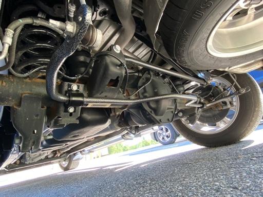

It's on both sides to keep the bar from moving side to side for extra stability. I have the lifted version, it may not come with the non-lifted sway bar.
Thanks! Makes sense I don't have that piece with a non-lifted truck.
Installed My Hellwig and timbrens!
Towing with the Hellwig sway bar.
