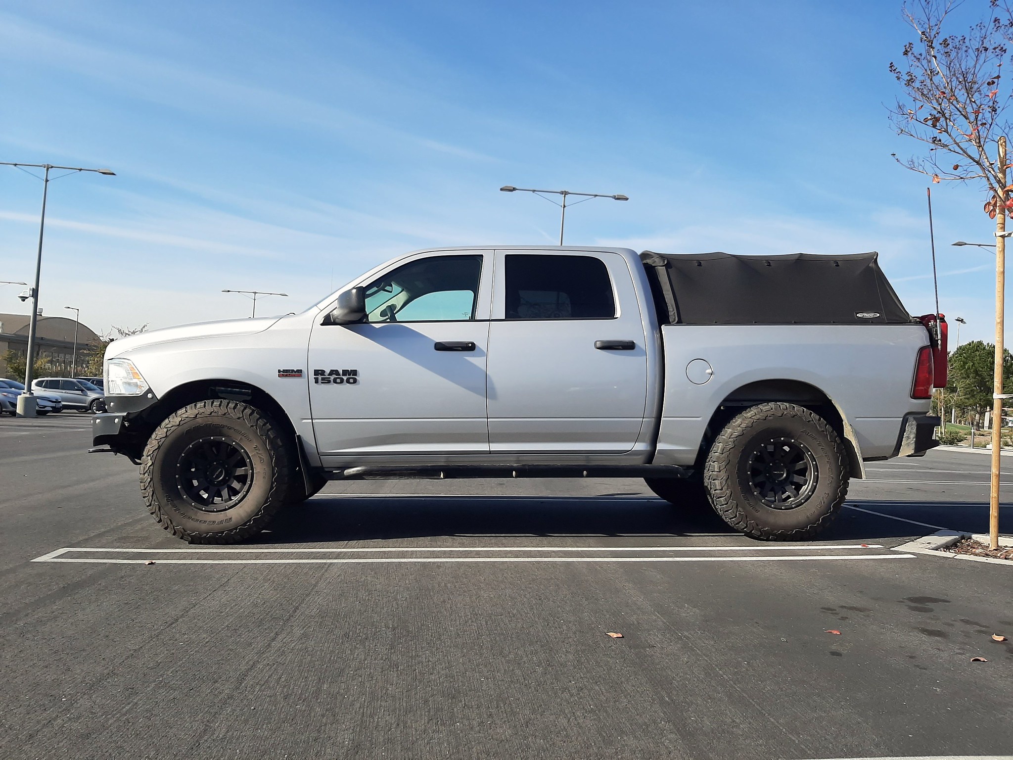

prob not the best pic here but i didn't have any rubbing turning with with Rancho QL struts, which is basically setting me up for 2" front. These are 17x9 -12 offset wheels

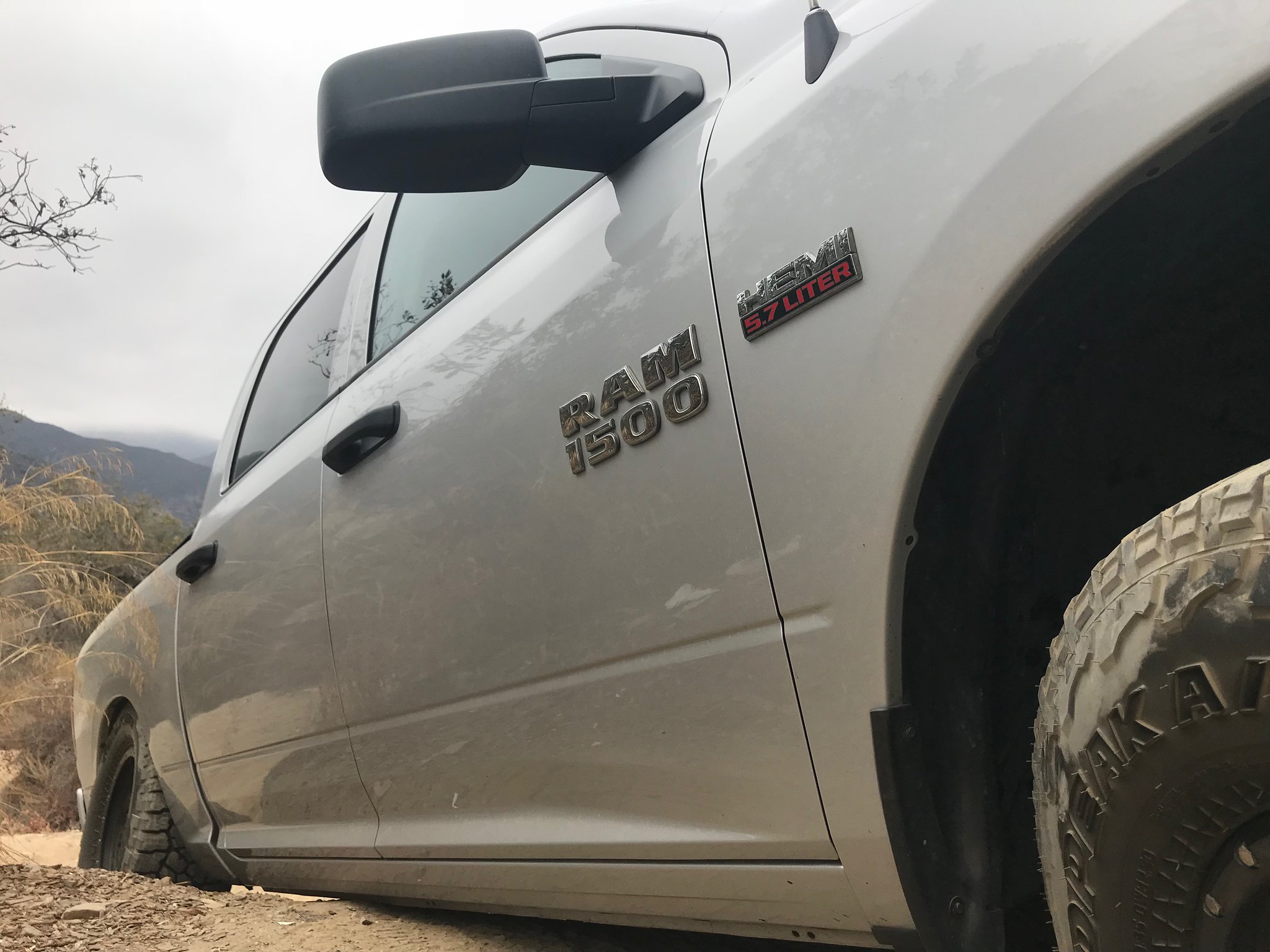

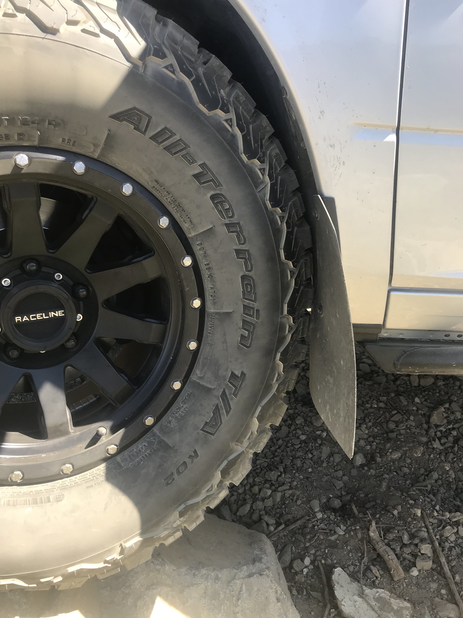

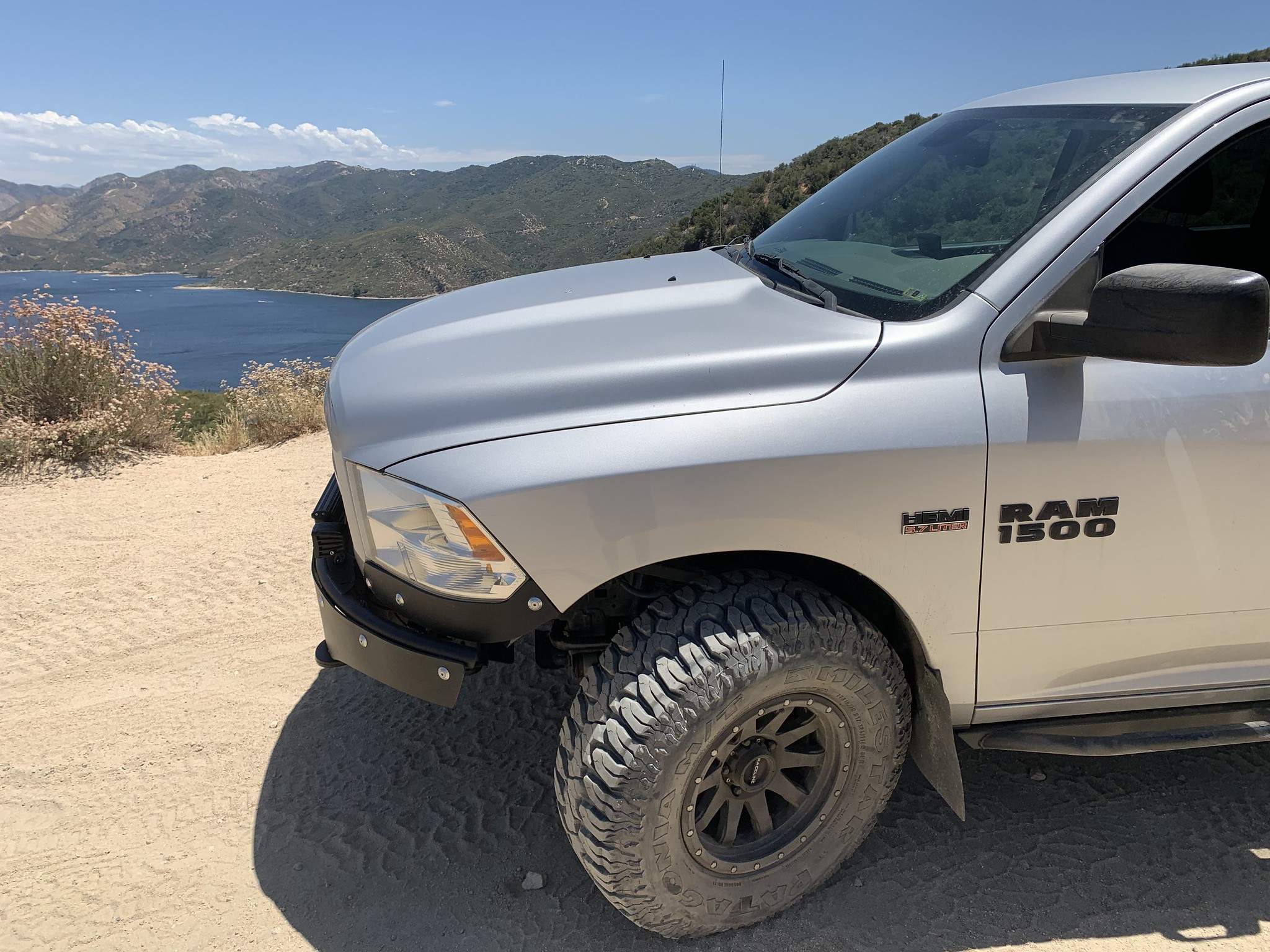

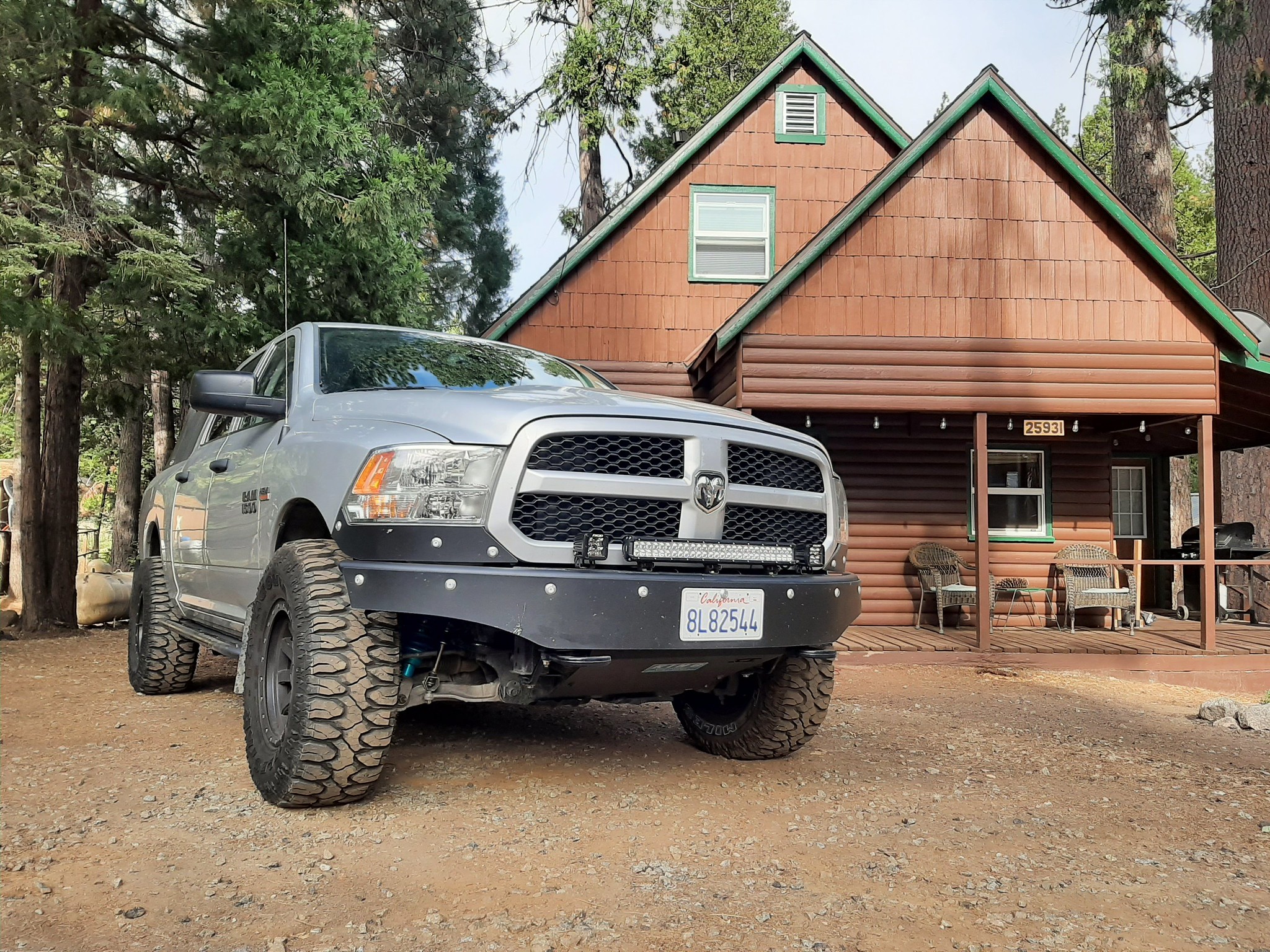

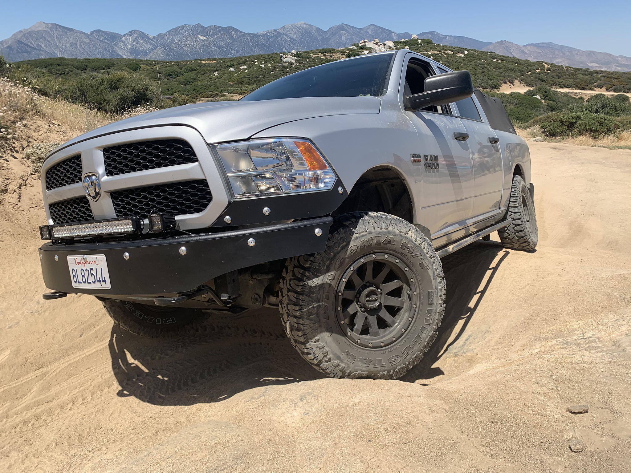

Later on i went Kings, prerunnner style bumper and BFG KO2's in 37x12.5x17, setup for 2.5" then cranked the CO's couple of turns up for 2.75" lift. Ran those 37's hard for 12-13k miles in the dirt, i had cosmetic rub, didn't cut any metal
This is how much i rubbed offroading on 37's with a small front lift
Untitled by RAM RSM, on Flickr

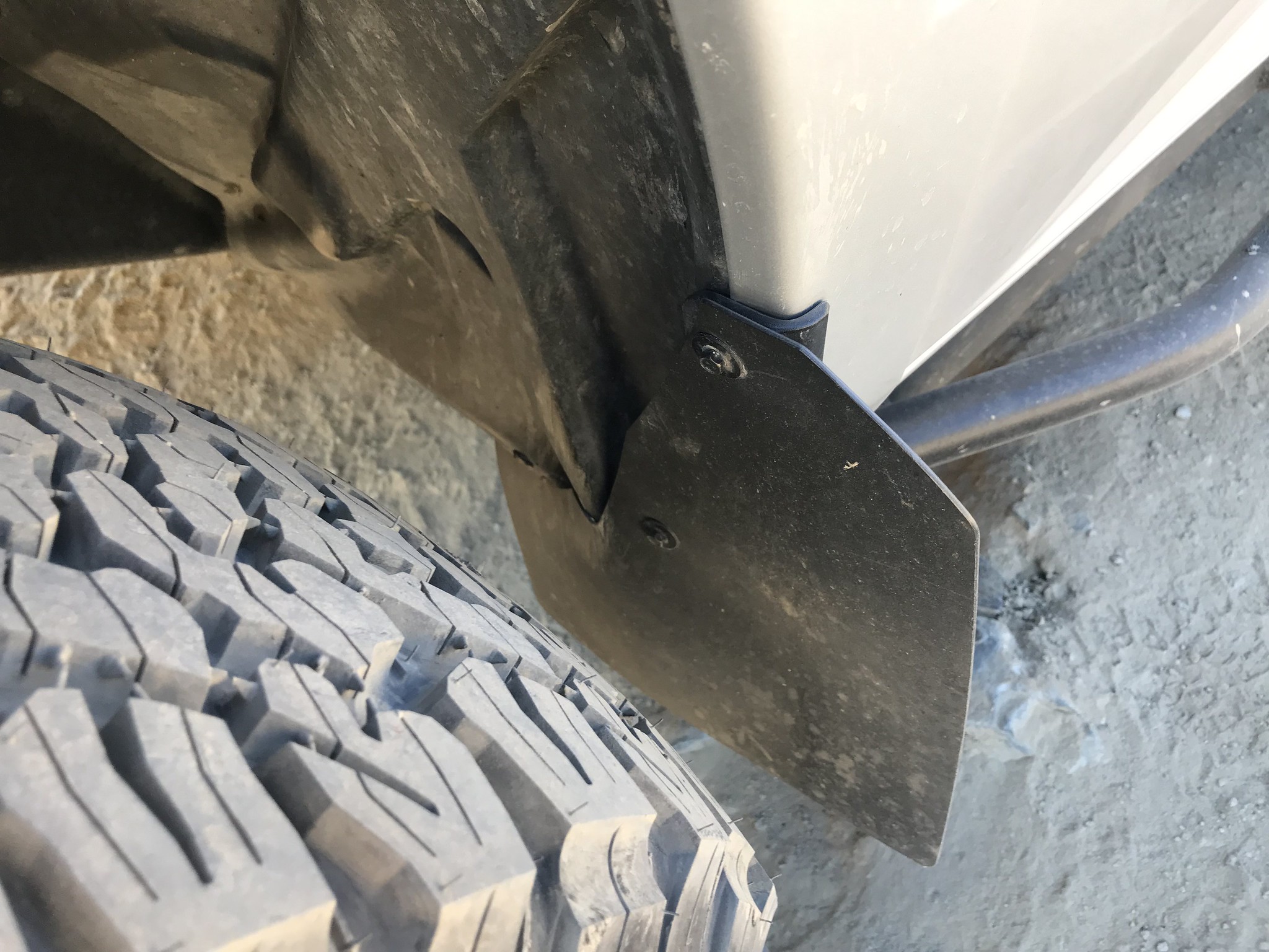

as you can see it's just cosmetic rub and i didn't have to remove the front fender wells at all. (i cut a portion in the front because to match the lines of the bumper)

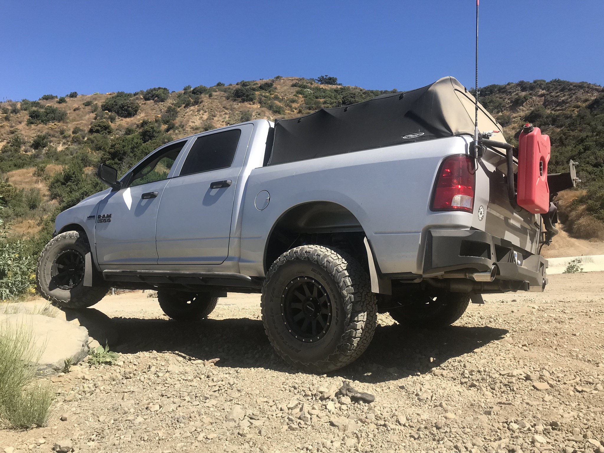

For the rear i removed the fender wells, and i'm also running 1" rear bumpstops
2020-01-04_03-39-10 by RAM RSM, on Flickr
i can turn even if the wheel is tucked in because of a rut
