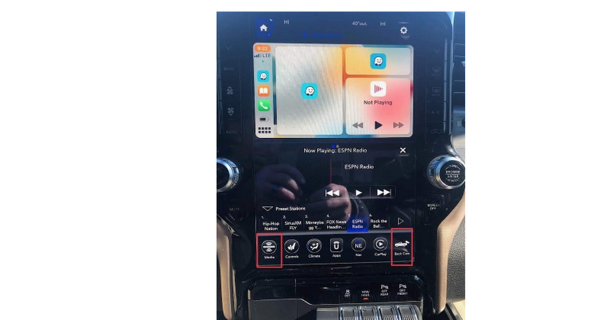

The pushing the bottom left and right for 10 seconds to get the version information DOES NOT
work on a 2023 UC5.
