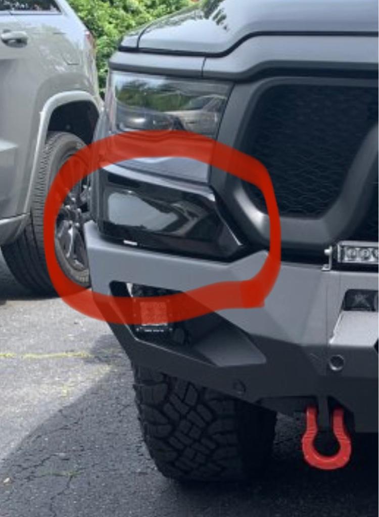

Also, something to think about… Are the light panels different on the rebels? Looking at the stock image of the bumper on the red truck above, your gap is huge in comparison. It seems like you have almost an inch to fill but in the image there is practically no gap at all.

If your talking about the panels below the headlights then yes, rebels are 2" shorter. which explains the gap. My gap now is like 1.5", but the OEM bumper had about 1- 1.5" gap also. Red truck is not a Rebel.
Keep in mind i rushed the install, and i might actually be able to do some more adjustments, but they are pushed up as much as they can go I believe.

Interesting, thanks for sharing. It could also be the style of your particular bumper. Looking at the black Rebel above with the non Rebel bumper the gap appears at the grill but not the head lights but it could be the angle. Either way it looks good, just pointing out observations for others who dive in. I see in your last pic you have it pushed up as high as it will go.

yeah i agree that looks like a smaller gap. Possible reasons.
  • That bumper allows for more adjustment
  • mine might be tilted down a little, (still adjusting) making gap appear more.
  • Could be my camera angle also
  • this one could look like a smaller gap because the truck is black, mine is silver.
  • shadows
  • I think the person that posted that pic said they ended up getting some brackets modified, maybe it was another person.
Please note: If you look at this picture, that point/swoop (dont know what to call it) the part that points toward the grille, notice its closer to the grille than the bumper is to the head light panels. Mine has an even (although bigger) gap along the headlight panel and at the pointy part. If i were to go ahead and push my bumper up anymore, it will close the headlight panel gap, but will also make that grille gap by that point part to be way smaller and not even.
I also totally forgot to mention that the brackets that attach to the truck allow for 1" of adjustment, and then the bumper when it attaches to the brackets allows for 1" adjustment. Ill need to check, but I am certain i pushed them all up.

guys my bumper i modified the mounting brackets and raised the holes 1.75 of a inch which gave me no gaps
