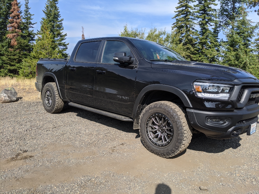

Do you have a picture of your rebel with the 5100s?

Here is mine with 5100s on setting 5

Tire size any trimming/rubbing?
Stock duratracs (33.2) on fuel rebel wheels -12 offset. No rubbing but very very close (1/8") clearance from weather tech mid flaps.
Planning on 35s, but really don't want to lose the mud flaps. Anyone figure out how to make this work?

Do you have a picture of your truck?

yeah you gotta bend the bracket thats behind that little oem mud flap trim piece. I have big *** husky mud dogs on my truck with 35's, had to trim them a little bit but take your time and you can make yours work and it shouldnt be noticeable
