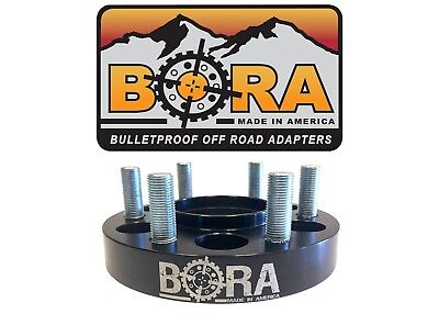

I have the 2019 Ram Rebel with the stock wranglers off road tires. I'm thinking safe and just go with the Bora spacers, 2" ... Anyone can send a direct link to buy the right fit?

I ordered the Bora wheel spacers for my Rebel, had them on my silverado 50K miles no issues. Dodge Ram 1500 (2019-2020) Spacers, 6x139.7 Bolt Pattern, 77.8 Hub. Aluminum, BORA Black, Thickness=2in (50.8mm) (75.180.227.143)
Thanks, you got a link for them? I think I found them on their website but their price is pretty hefty considering it's just spacers...
I put the specs in on their site, for some reason won't let me copy and paste the info. But I agree they are a little pricey...but I do trust Bora spacers more so than other brands.
