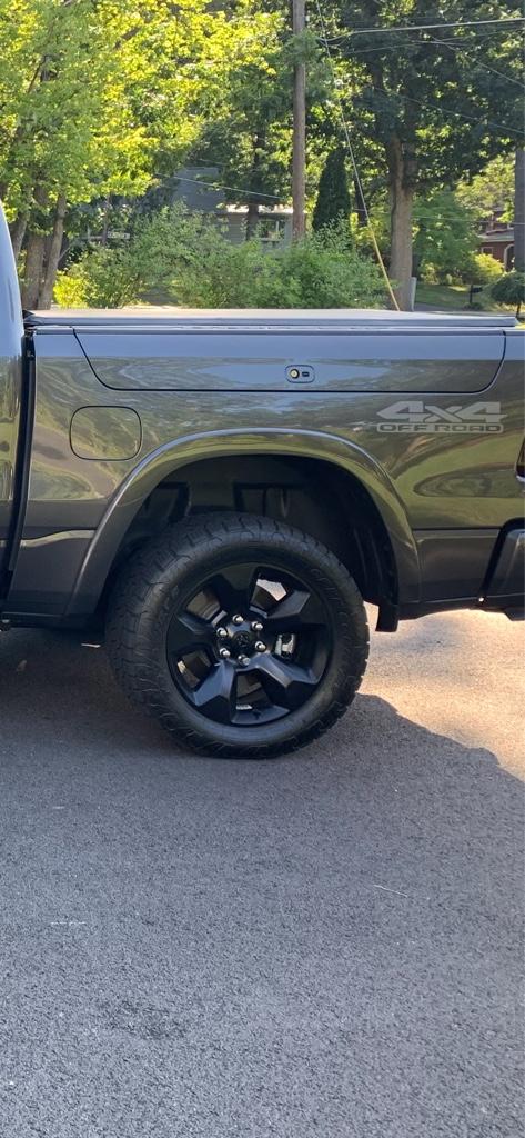

Did you have to trim the front studs with the 1'' spacers?? Also, thank you for noting the 1/4 difference too. I just put 305's on my 2020 Laramie and want to square things up to the wheel wells.

^^^ Looks great. I did not have to trim the studs. They protrude past both the 1” and 1.25” spacers, but the OEM Rebel wheels have corresponding indentations so the wheels set flush.
Edit: If you don’t have those intentions in your wheels, then I’d say that you’d have to go to at lease a 1.5” spacer to clear without trimming the studs.
Ok thx for your input. I hope I have the indentations, the rims are very similar to the rebel. I’ll take them off before ordering to make sure. If that’s not the case I think 1.5 and 1.75 will be too much with the 305’s

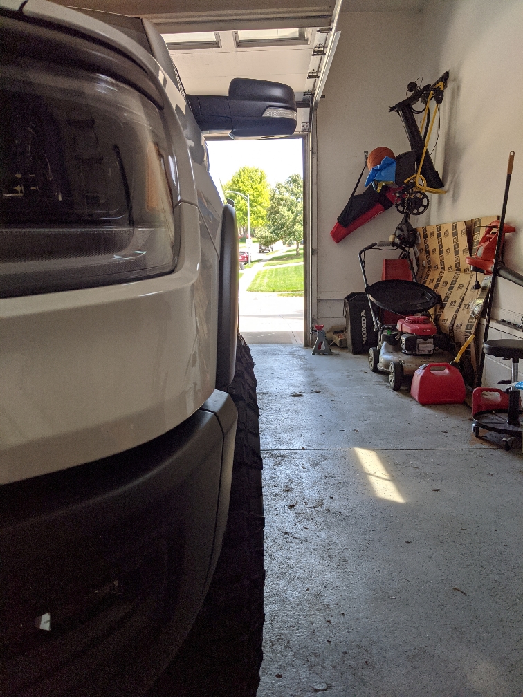

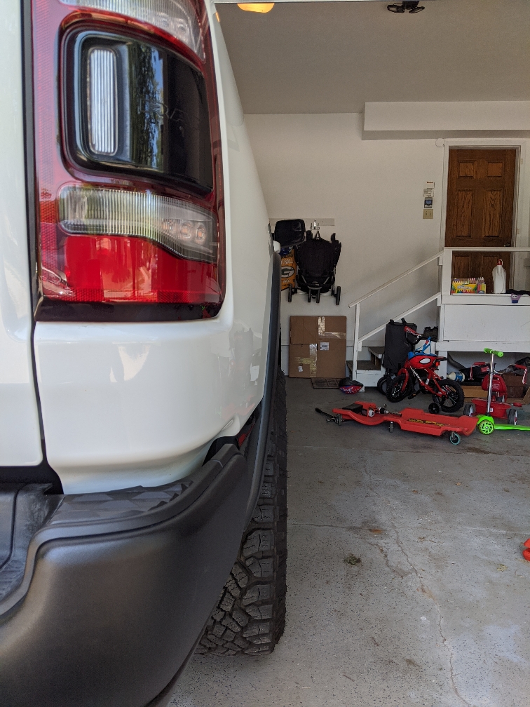

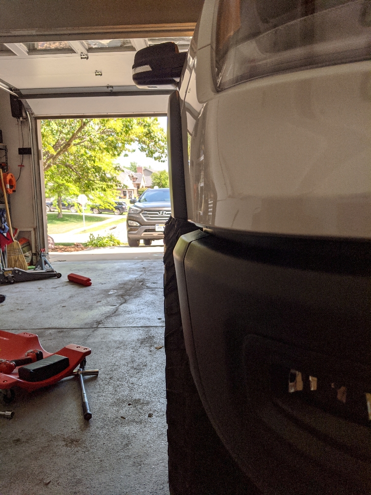

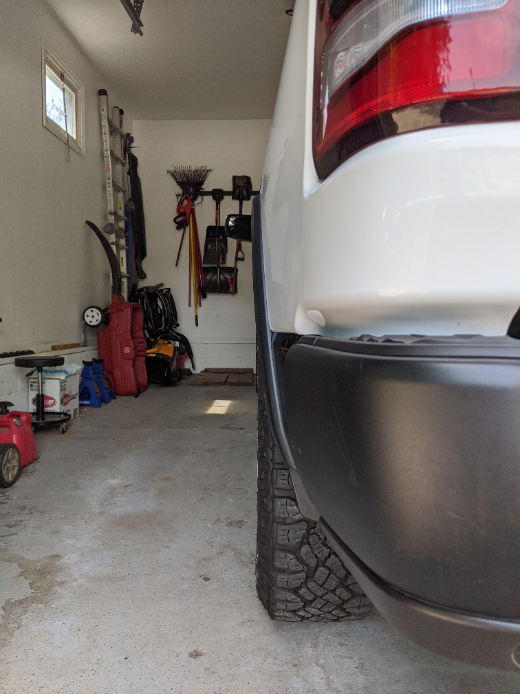

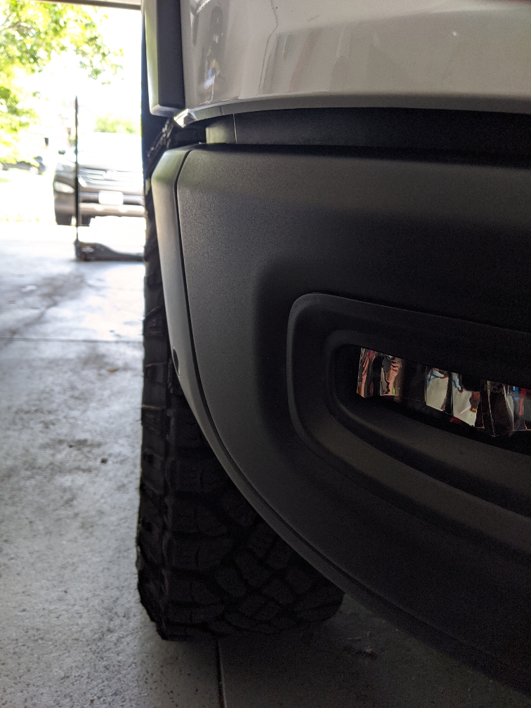

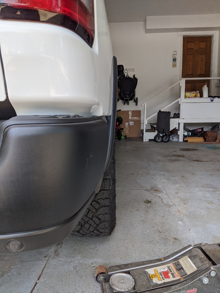

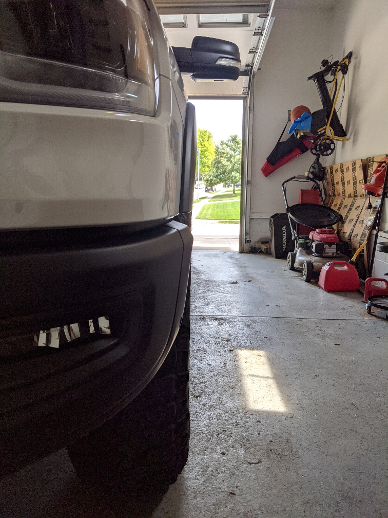

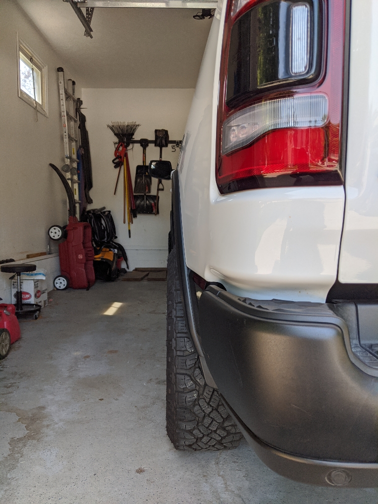

Got impatient waiting for the front 5100s and installed the spacers a little bit ago. The first four are the before pictures, next four are after. Not sure if the quality is good or not. They stick out a tad further than I was expecting, but I don't hate the look. I think 1/1.25" is probably perfect. Next time I take it out of the garage I'll get a profile and if you want some better lighting for the sides.

I think it looks great. Nice job! (y)
Funny, I was just looking at the pics in the thread and my truck looks like I have a leveling kit. The front suspension didn’t settle yet after jacking when I took the pics. Looks like my next mod will be a leveling kit :D
