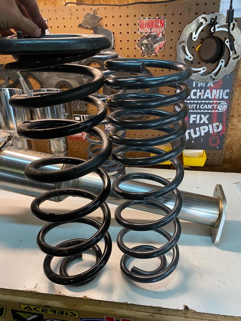

Are you sure you got the right springs? Looks like the upper part of the spring is completely compressed??
Yeah thought it was weird too but I checked the part numbers and they matched up. Unless the spring was labeled wrong or something. They are a dual rate spring and that top part was much softer so I think the airbags are just pushing up on them a bit.
Yeah that’s normal looking
I reached out to Maxtrac just to be sure and they confirmed the springs look correct. Here’s the email.
I can’t remember if it was you that talked about the springs making noise when they compress. I talked to Maxtrac directly and they said it was the first time they had heard anybody complain about spring noise (which is really called binding). I ordered a set that will be here on September 29, so I’ll see how mine work out.
