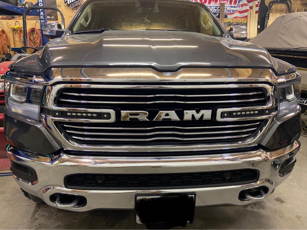

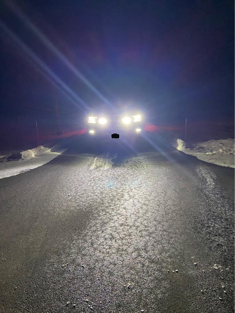

Installed the Rough Country 6” grille light kit today, took a bit of time to install but was worth the effort. They are a flood light so they light up the ditches better and should make it easier to spot critters that roam at night.
Appreciate your picture. Those certainly appear much brighter than I would have guessed. I've been planning on getting them, but wasn't sure they would be bright enough to be anything more than running lights, or DRLs.
How'd you wire them? Dedicated switch, or with running lights/high beams, etc.?
Thanks...where did you go to bring the wires up into the cab for connection?
Ran the wires into the engine bay and through the firewall. On my limited, there's a small nipple below the main wire bundle coming through the firewall. I snipped the end off of it, ran a piece of wire through, and tapped into the foot well lights. Backfilled with some RTV sealant where I cut.
Thanks...haven't looked to see if there was a grommet in the vehicle floor we could come up through. I'll check it out closer and look at the grommet you mentioned. Where did you pick up the hot wire for when the door is open?
