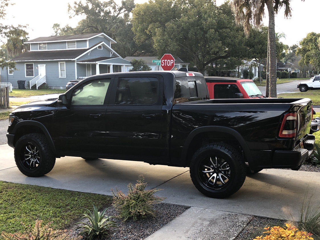

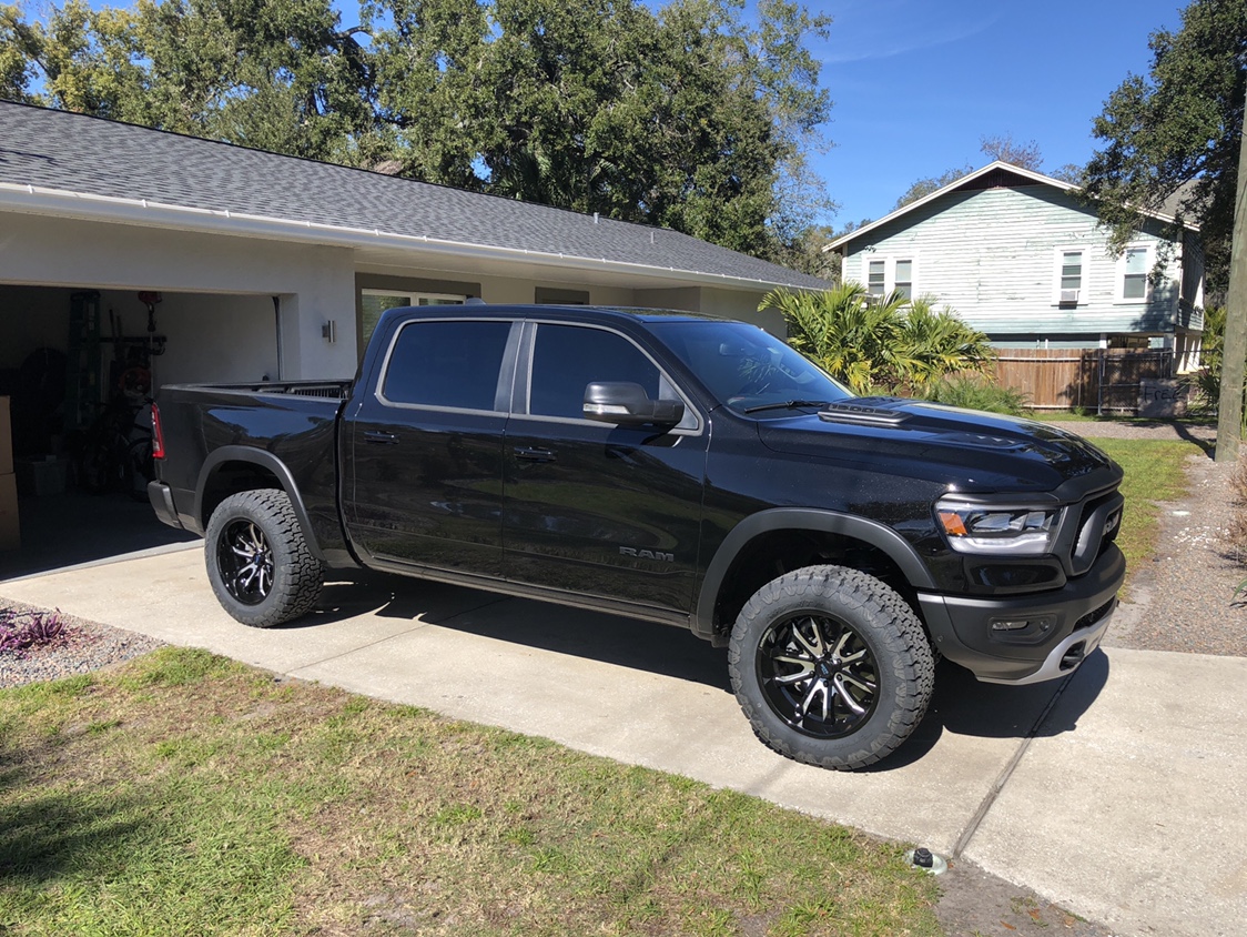

2” Ready lift leveling kit with 20x10 Moto wheels and 305/55/20 tires
You need to put some dressing on those tires!
