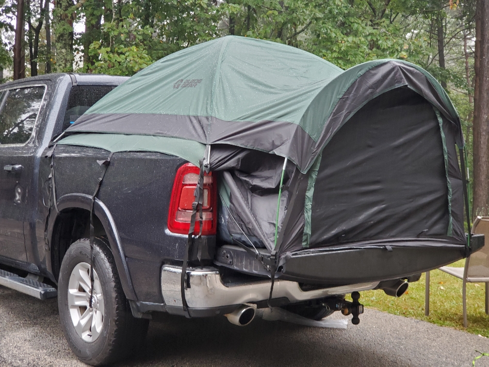

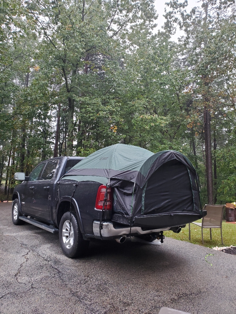

Got in a Guide truck tent for some light Overlanding. Slipped a mattress in there and fit perfectly. Wheels, tires and lift coming next week so just about time for some adventure.

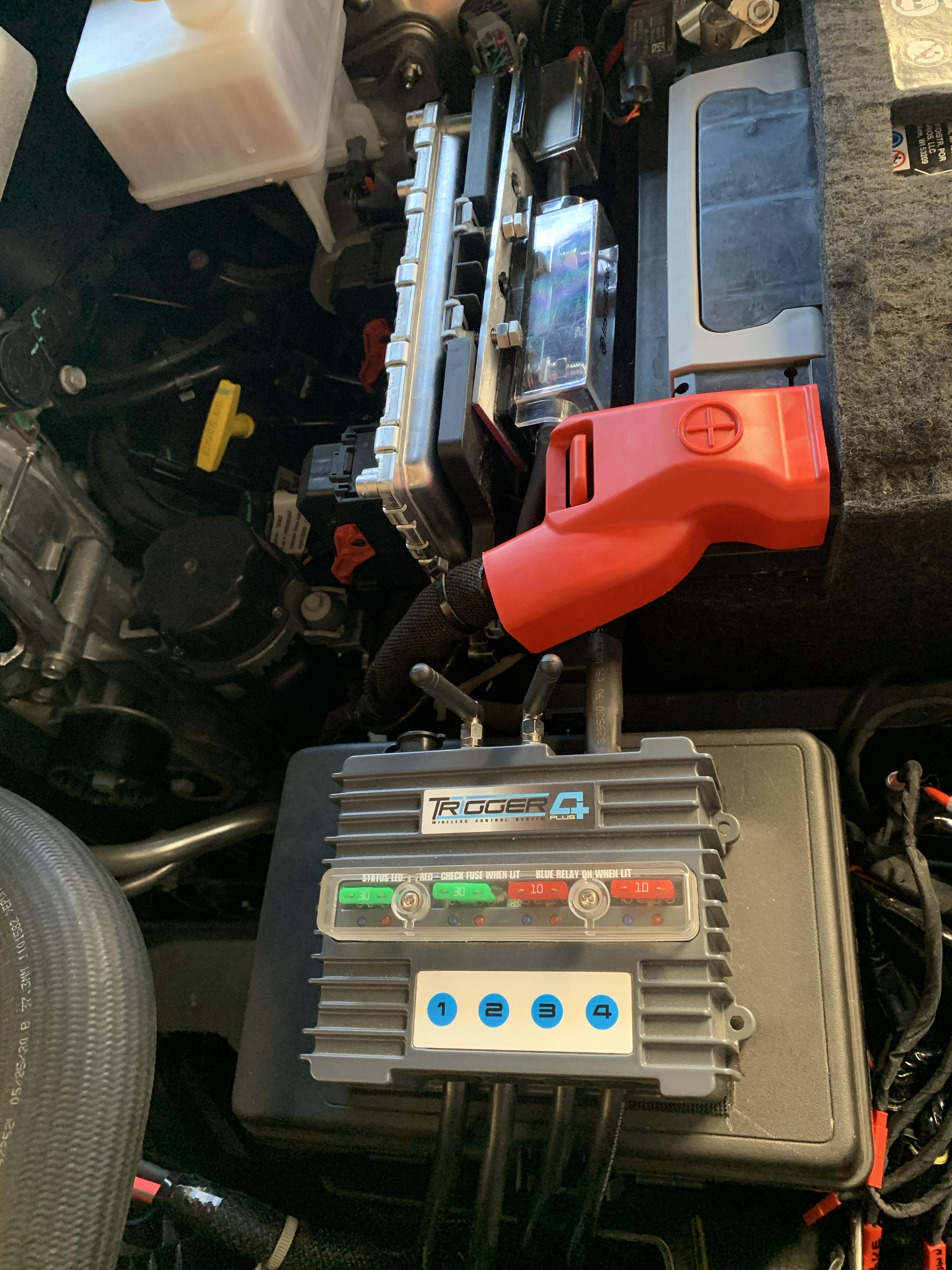

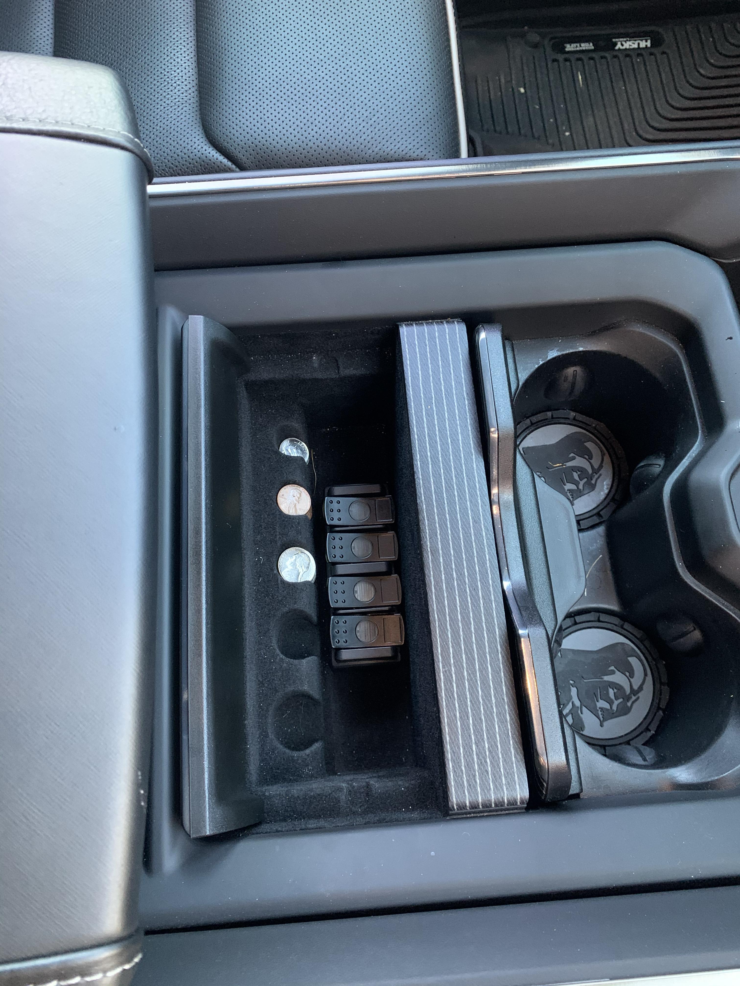

I installed my TRIGGER 4 PLUS a while ago knowing that I was going to be adding accessories to my truck and I didn’t want to have to drill any holes to add switches on the interior of my truck. This was the best solution for me. The TRIGGER 4 PLUS includes a small plastic unit that has four wireless switches on it. The wireless switch unit is kind of cheap feeling but it functions well. The wireless switch unit can be mounted anywhere inside the truck. I just dropped it inside my change compartment. It fits perfectly in there. I have it hooked up to a switched fuse on my truck so the system only turns on when the accessory switch is on or the truck is running. The TRIGGER 4 PLUS has two 30 amp connections ( Switch 1 & 2 ) and two 10 amp connections ( Switch 3 & 4 ). I am currently using switch #1 ( 30 amp ) for my onboard air system and my Train Horns and switch #4 ( 10 amp ) for my LED lighting. There is one thing I do not like about the TRIGGER 4 PLUS. The system does not remember the last switch positions after you turn off the truck. Basically if you had a switch turned on before you turned off the truck, you would have to turn the switch off and then on again to reactivate The accessory hooked up to that switch. It is kind of annoying not knowing if the accessory is powered on or not. I came up with a solution. I tapped 4 red 5 mm LEDs into the 4 switch wires coming out of the TRIGGER 4 PLUS. I made a small bracket out of angle aluminum and mounted it with heavy duty Velcro it under the hood so I can see the LEDs. Now I know if the accessory is powered on or not.
