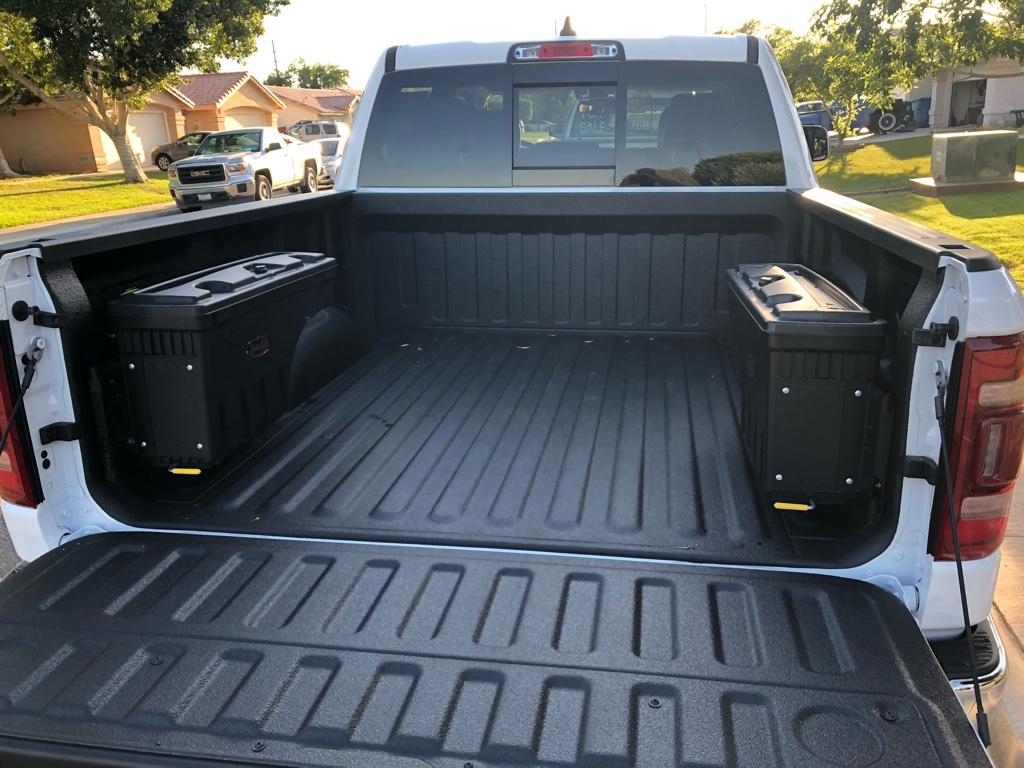

Installed her first additions today. Wheel well liners and undercover swing cases with a wash and wax for good measure afterwards. I think my gen 4 sitting out front for sale and watching is getting jealous.
Been looking at those cases. Can you tell if they would work with the cargo rails in the bed?
I don’t see why they wouldn’t. The swing cases don’t sit flush against the fender to allow enough room to open the lids without having to swing them out. There’s plenty of room behind there to accommodate the utility rails. I’ll try and get a picture with a tape measure today to show the clearance.
Being a previous owner of swing cases I will make one suggestion. Take the boxes to get lined. Don’t have them do the tops because it adds weight to the lid which overworks the hinges but definitely get the body of the case lined. You’ll thank me later when you pop the side of your case with a piece of steel and it happily shrugs it off rather than punching a hole through the poly.
