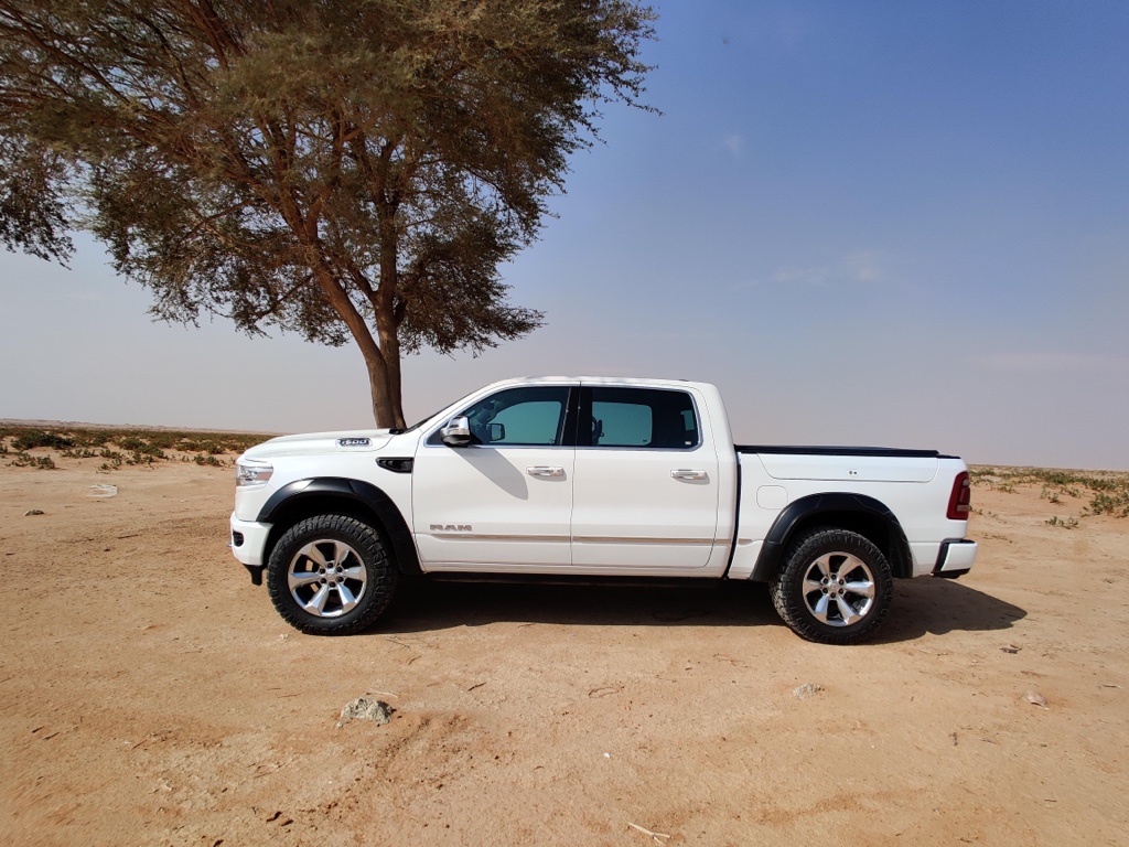

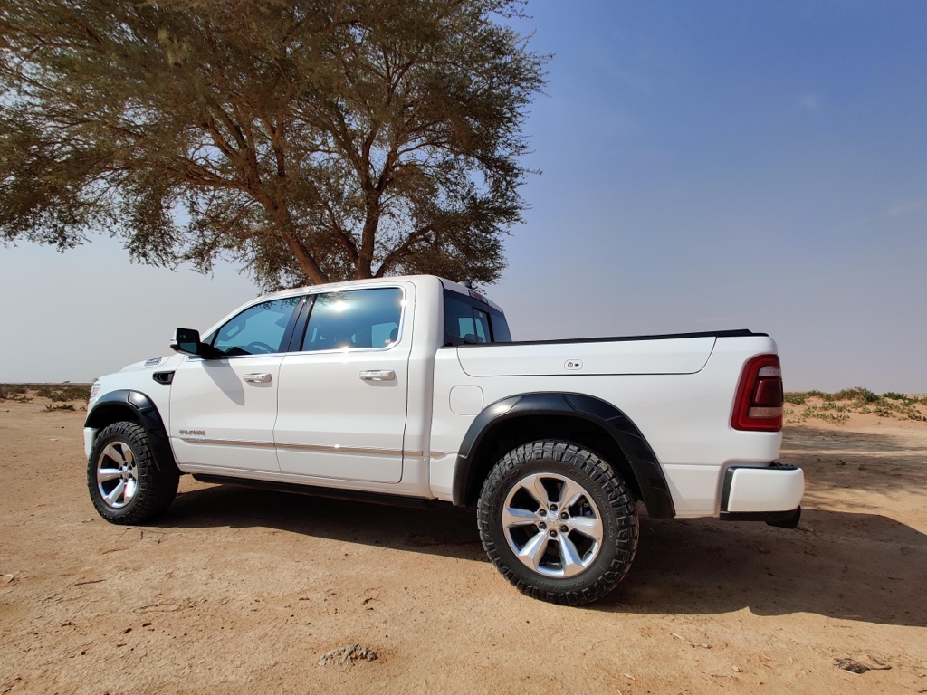

I am about to start installing RC 2" leveling struts. Taking double safety measures with solid wood stand on the size I will be working on as a backup.20191214_090356.jpg20191214_085934.jpg
First side took 3 hours, mainly 2 hours to get UCA ball joint to separate. After that all was easy. Working on the second side and it took 3 hammer blows to separate ball joint. Looks like RC struts about the same length as OEM and they just use stiffer coils.
Truck is still on stands but I had to raise it up to get tire back on with new struts.

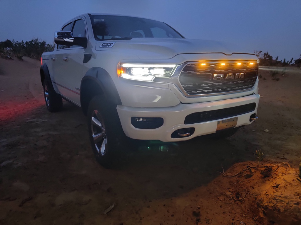

where did you get the running lights on top of the grill?
Some Chinese knock off from eBay for the Toyota Tacoma.. surprisingly it fits like a glove! I put 3m double tape to hold it in place. you can also hold it from the sides with a zip tie.
something like this
something like this
thanks much! easy wire-up?
