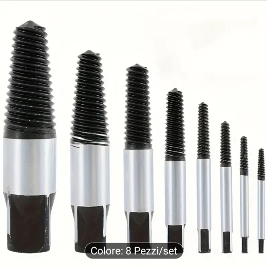

@RAM REAPER MAN, please find these specific bolts:
after the drill you will insert this bolt in reverse

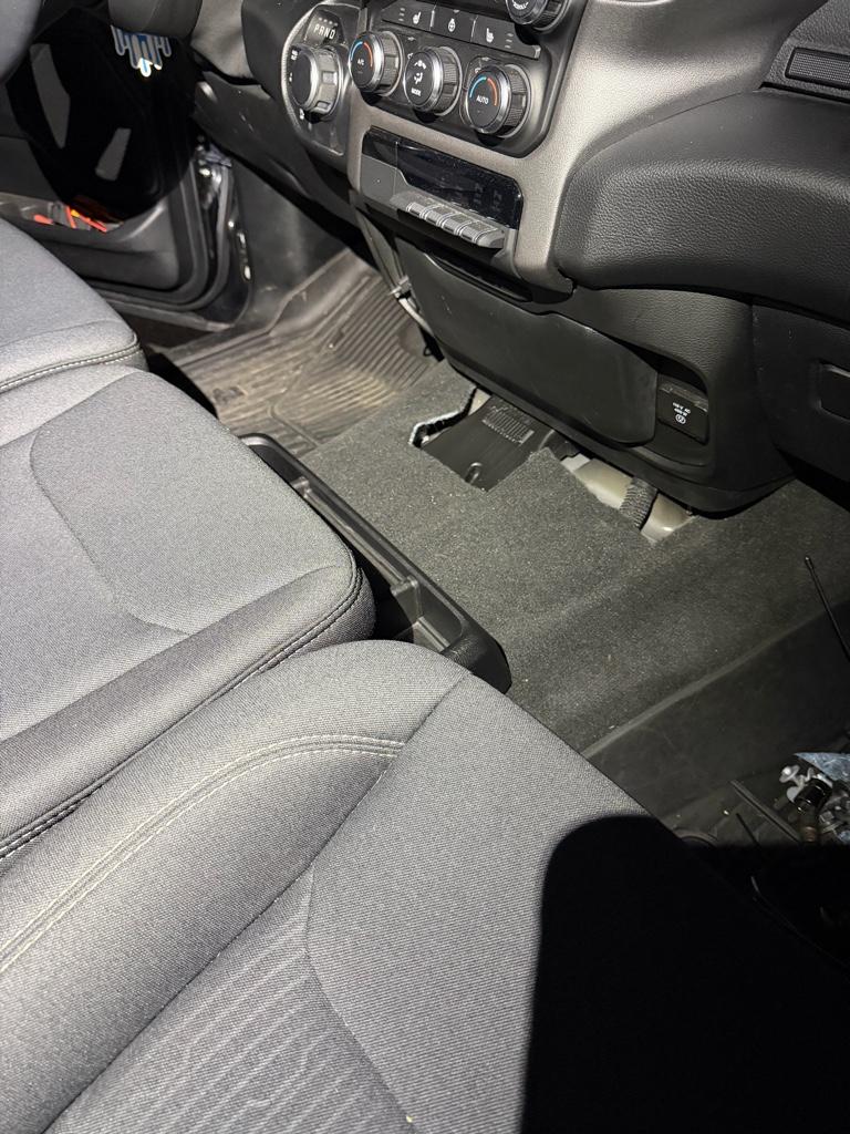

Installed a jump seat. Miss the center console but it not my daily. And family first. Needed the extra seat sometimes. Didn’t realize carpet was an issue. Will order new to replace.
