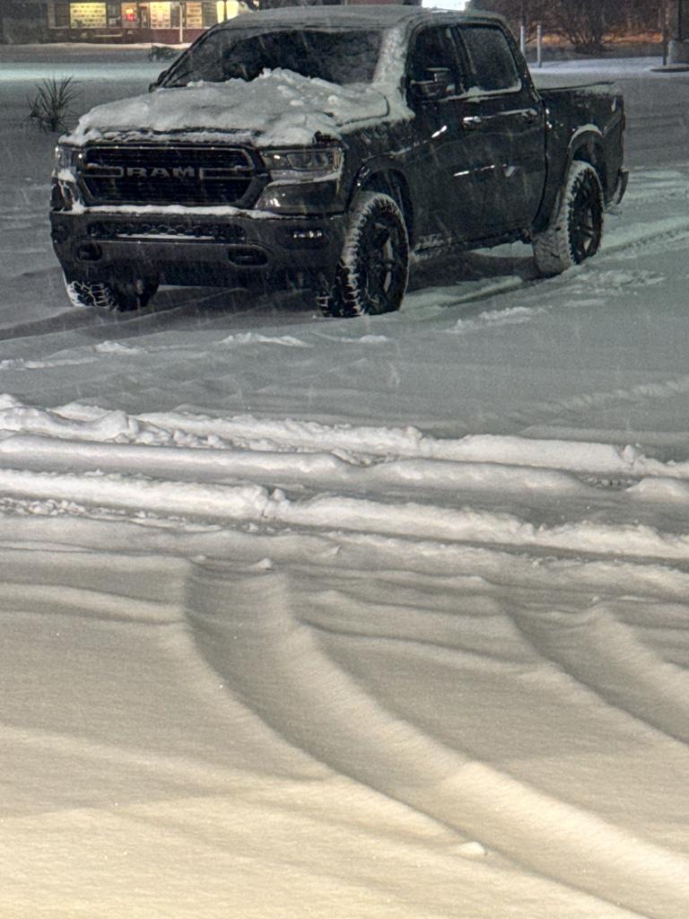

Drove it through some white fluffy stuff empty gym FTW. Yep snow in NW Florida, the world’s definitely coming to an end.
