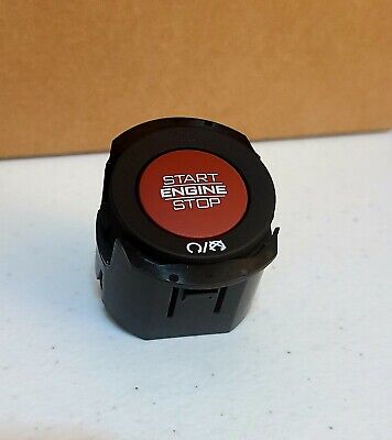

Plus, it adds an easy 10hp.😎
Took me longer to get switch out of packaging, then to actually install it.
For those installing; it's waaay easier to pull lower panel and pop switch out from behind, then to remove panel switch button is mounted in. That panel is a prick to sneak by instrument cluster bezel when re installing
