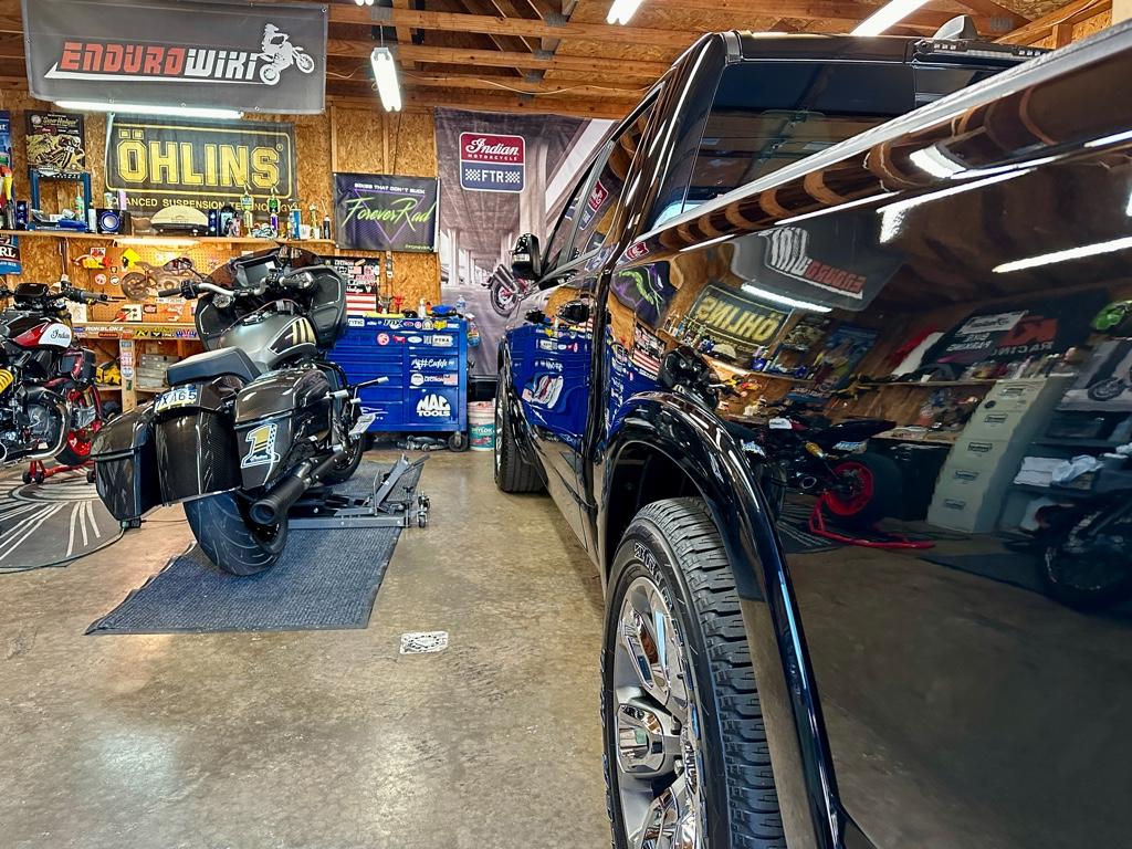

I'm really curious how the 4 compares to the 3. Loved the 3's.
Me too. But comparing the Ram to the Jeep won't be an apples to apples comparison. I did spend the $$ and go 10 ply since I'll do some towing, so a bit different there too. Time will tell...
I have the ATW3’s in 275/60/20. I’m moving up to the AT4’s in LT285/60/20….big I see yours are 55’s. Do you run spacers? What size did you have before? They look great! Can’t wait to hear your thoughts on them.
Stock was 275/55R20. Stock rims, no spacers. Went up to LT285/55R20 in order to get the 10 ply. Only a 0.4" difference between the two in AT4W, making them 32.3"x11.2".
