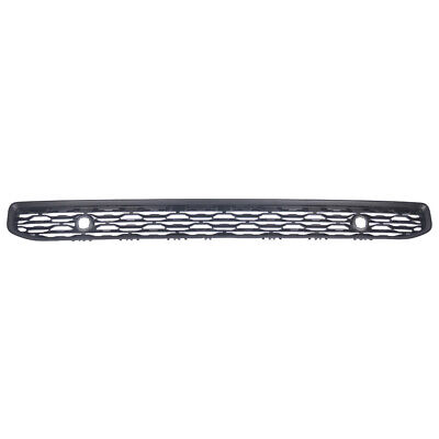

Check your lower grill before you get the light bar. You may need to replace the lower grill. My lower grill is solid so I had to get the one that is NOT solid but still has the sensors.
You are correct! I checked it last night..and solid, so new lower grill will be needed. Still have the PN you ordered?
